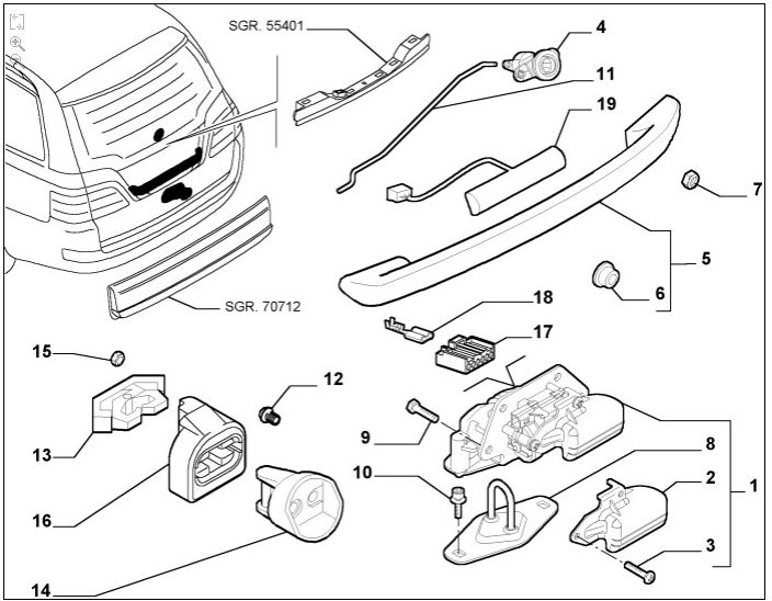

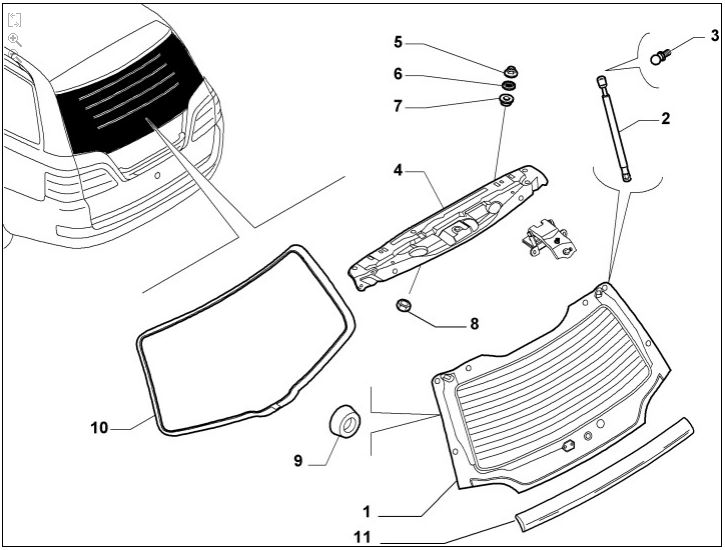

Yea... but I would buy some trim fixing kit before starting the job as the plastic clips that press into the holes on the tailgate always snap
Remove it with a bit of wriggling and force and then go to a motor factors to get some new white clips.
You may also break / snap the holders for the clips on the trim itself... if so your knackered and new trim isnt cheap - try source from a breakers.
I know that the 3dr side trim is like 70 quid for two pieces!! Becareful.

sgr 70712 is the part number, but iv managed to prise it off, it was just sealant holding it on, iv made a mess but a bit of spray paint should sort that, thanks anyway davren.
