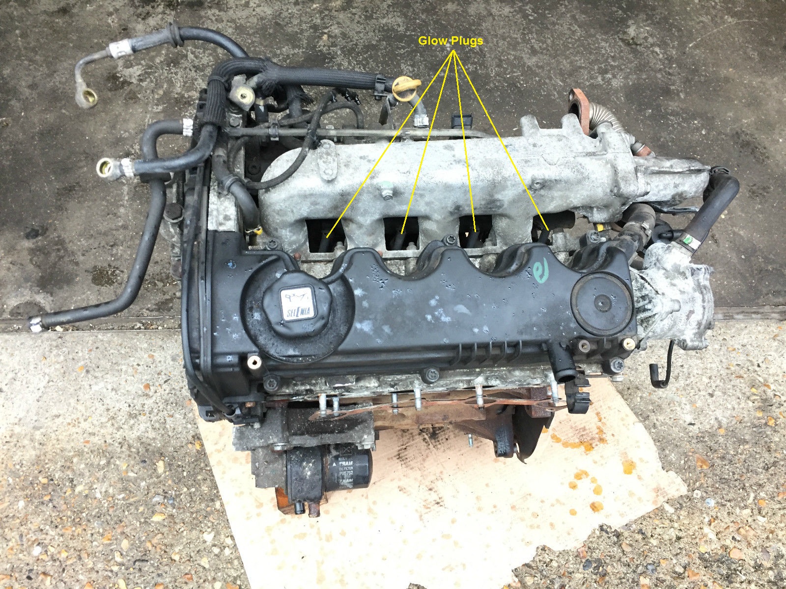

I have had the check glow plug warning on dash when starting up for a couple of weeks. I’ve just purchase a new set, 10mm deep socket and thought that I would change them, but I just can’t locate them!! Are them shoehorned in somewhere?
Any help and guidance would be greatly appreciated.
Pictures would be good.
Thanks in advance.
At the back of the engine. Quite difficult to see and access.
