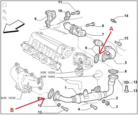

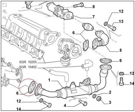

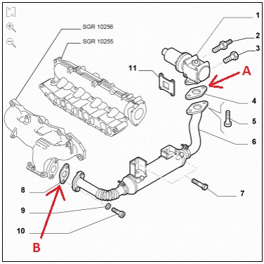

The best thing to do is block off the EGR system completely by placing Blanking Plates at points "A" and "B" in the diagrams as I have done.
But if you have only one Blanking Plate position "B" is the best place as emzo has done.

Well, I cannot put a blanking plate on An as it is impossible, I really cannot get the bolts loose and I try every time I clean the egr. they are so so tight, dont think its been off since the car was new.
On the diagram you can see the bolt number 8 and it connects the electric unit thing, well that is where I clean as it get so full of black stuff there.
So would I see any difference buy blanking the B off???
Would it just be easier to disconnect the egr buy pulling the cable out of it?
Sorry so many questions but I like to know things before doing them.
Unplugging the EGR will probabely produce an error code and may effect the cars performance so I wouldn't recommend you do that.
Blanking it off at position "B" seems to be the best option as it prevents anything from the exhaust entering the EGR system so the system stays clean and trouble free.
Blanking off the EGR system completely(both ends) also reduces the risk of an inlet pressure leak(boost loss). I sprayed the whole EGR system with a 50 - 50 mix of water and washing up liquid when testing for boost leaks after I'd fitted a blanking plate at position "B". I found 2(they where small and probabely didn't effect performance), fitting another at position "A" cured the boost leaks.
