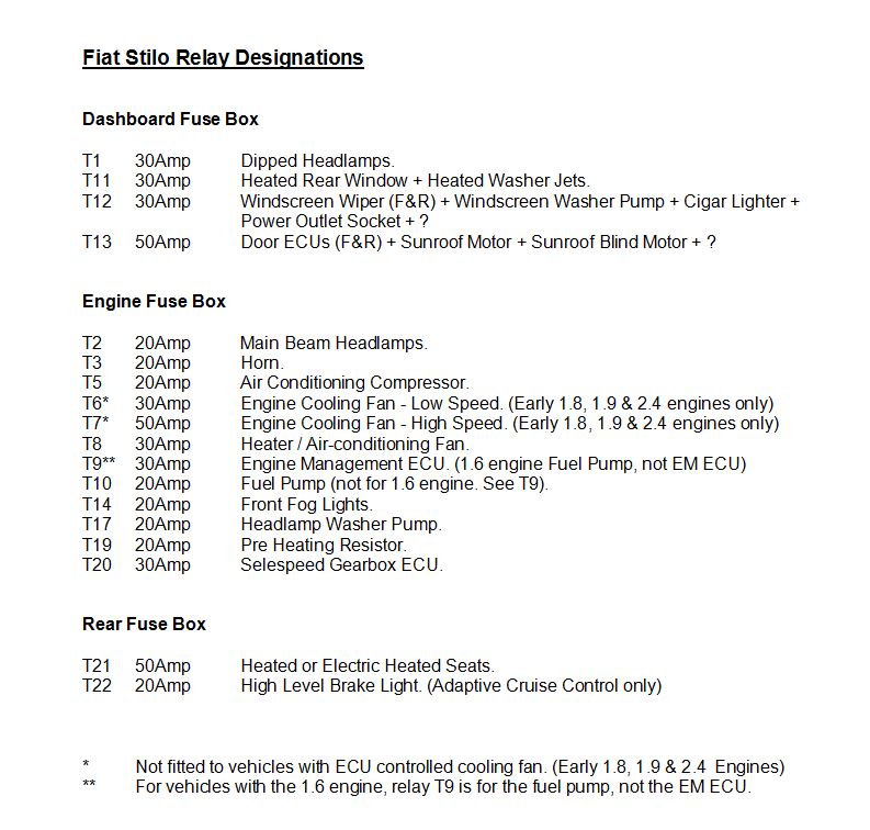

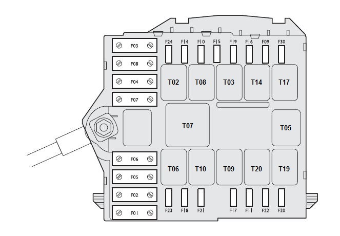

Hi all , could anyone tell me which is the horn relay please , a picture if possible would be brilliant, Iv already checked the fuse f10 , and tested the horn . My car is a 2004 abarth manual
Thanks for any help !
