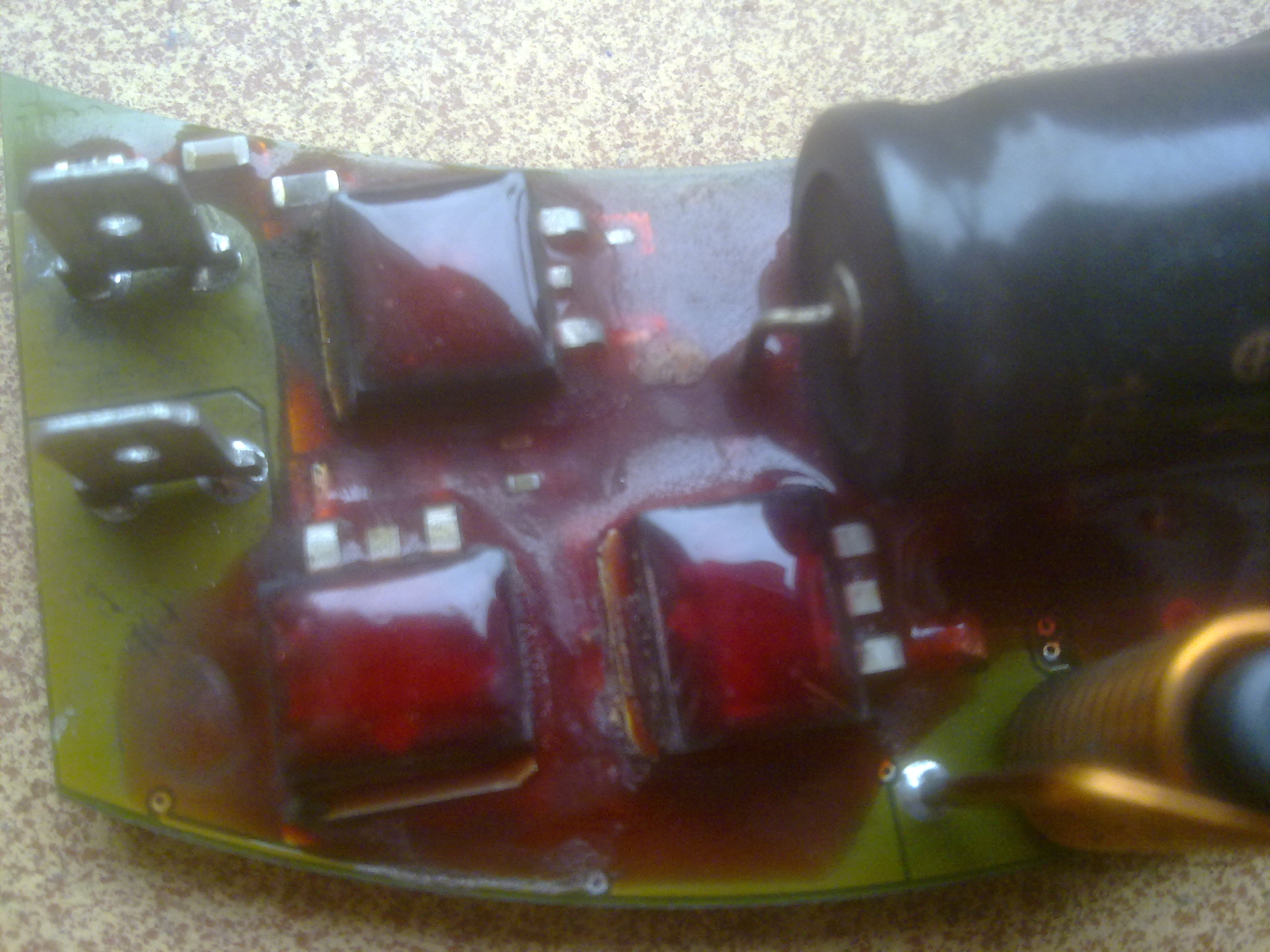

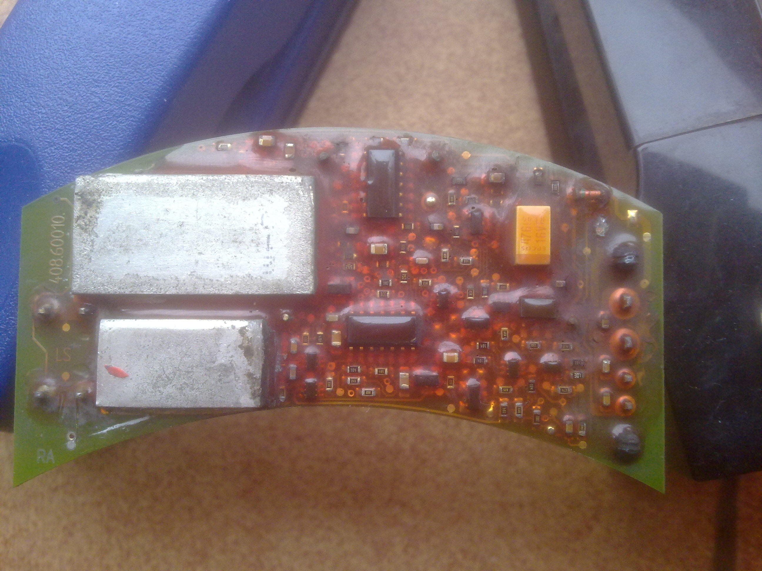

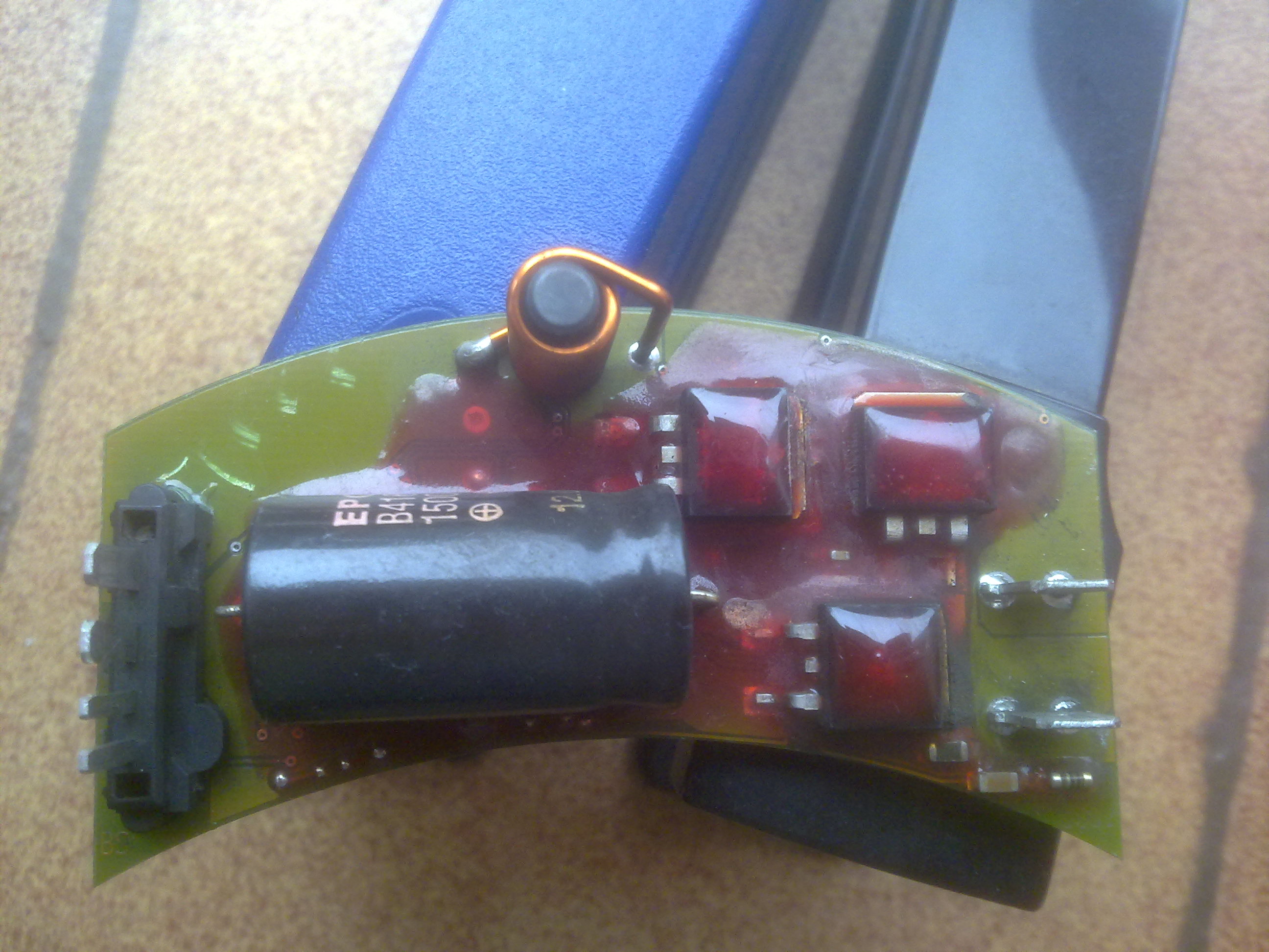

Much better pictures.
But I can't see anything on the boards that would cause a problem, no burning, deterioration the board etc
So the next step would be to check the output voltages from the board which you could try with your meter set on voltage across the two output terminals which go to the fan, you know the inputs of 12v, earth and the request signal is good on the 4 pin connector at the other end of the board so see what is happening at the output.
The circuit board has 3 x 3 pin ICs on one side and 2 ICs and a coil on the other which will be the timings/ logic so that looks like it's going to be a closed feedback pulse type speed controller ie it's going to pulse 12v on/off very rapidly to get the fan motor to run at different speeds and the feedback from the motor ensures a very accurate and monitored speed control so you may or may not be able to see what''s happening with a simple meter as it's not quick acting enough. But anyway, see what you find. If requesting max speed then I'd want to see steady max of 12v across the output terminals

It sounds as if the CB is at fault for although it's supplying 12v at the output then it has no power ie current so one or more of the amp semiconductors on the CB may have become cooked.You know the fan is ok as you put 12v across it earlier and it rotated at full power.
Imagine the voltage as being the size of a water pipe and the current is the flow of the water inside . The pipe size is ok but there's only a trickle of water flow so it has very little power.Volts x Current = Power
The flow is so inadequate that it is the equivilent of having a smaller pipe and that's why you see the voltage drop when you connect the fan
