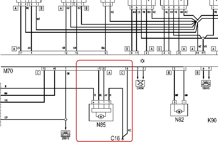

Check you have a good earth going through to earth point C16 from the fan circuit board connector pin 3 (black wire). Check you have 12v arriving on the red wire there pin 4
See what happens at the pin 2 (white+blue) as this is the request speed voltage and then pin 1 (light blue/green) is the return motor speed signal telling what speed the fan is actually doing

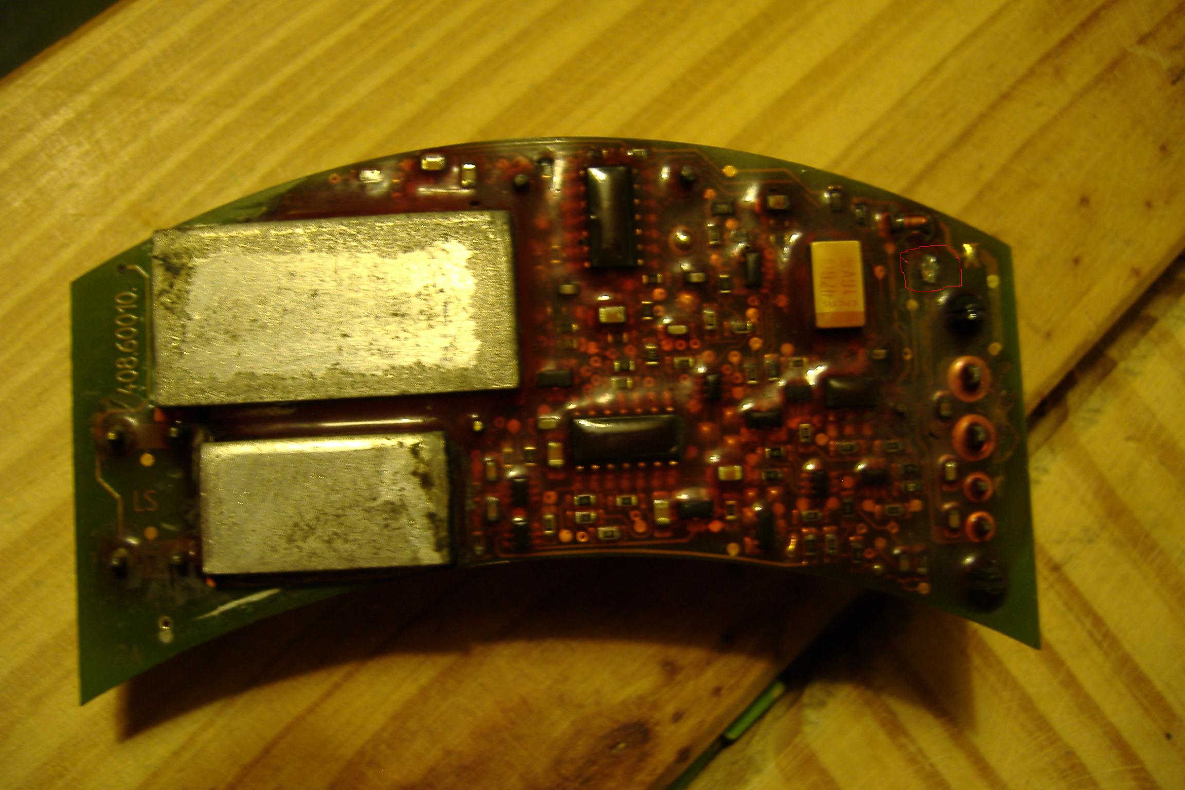

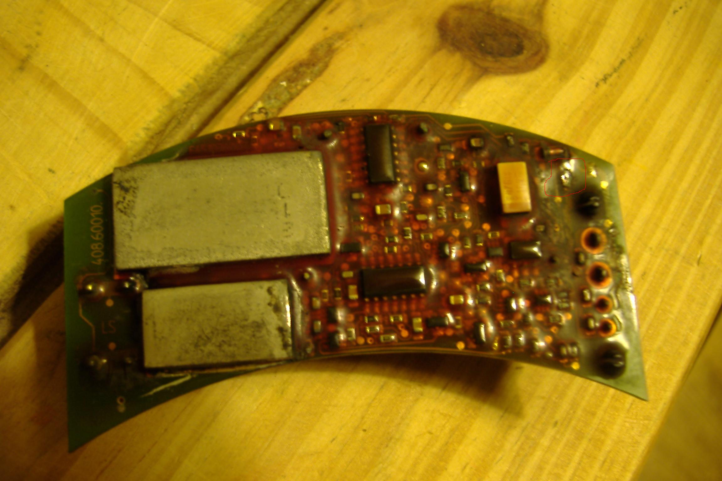

I had a closer look at the CB when I cleaned it up a bit, and without a magnifying glass, I could only see what I've circled that looks suspect.

If your PCB pics were much brighter and much more high def and showing BOTH sides of the pcb then we could have a close look for you but don't worry if you can't as it would only show a suspect area that you would need to investigate.

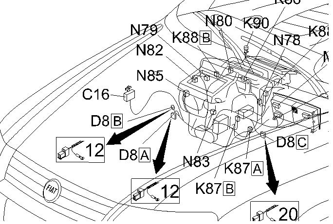

The earth point C16 condition is vital as it gives earth to the heater fan motor but also to the auto climate control module and that might explain why so many aircon fault codes are being stored
Drawings show C16 here but they are often wrong

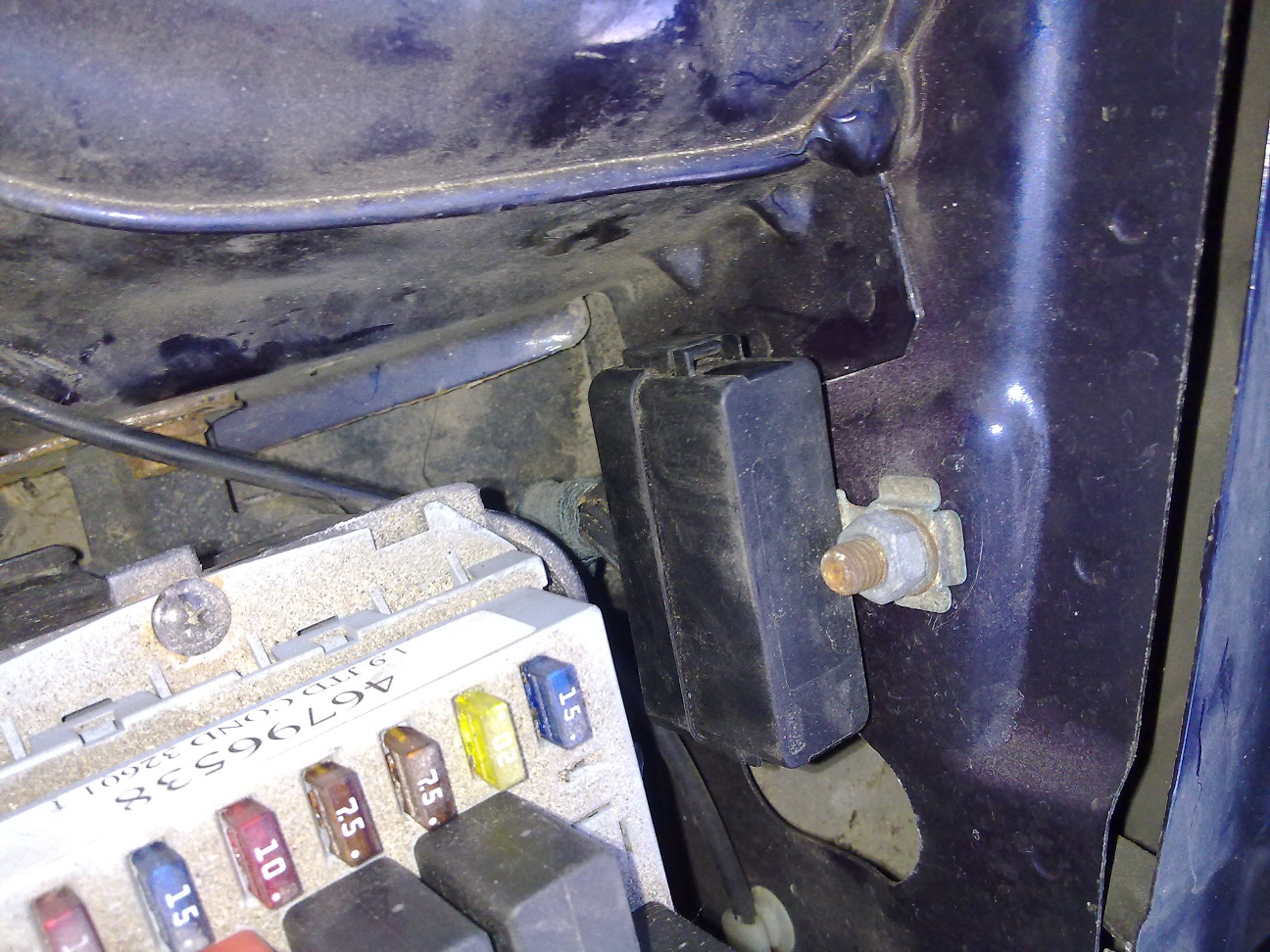

As I face a similair problem with my fan I took a picture of the small box that should be the earthing of the airconditioning system. Is this the right place? When I'm in front of the car it's on the right side. next to the battery.
That's earth pont C15 which deals with wipers etc but that's not to say the air con and heater circuit doesn't go to it because they do twist things around a bit when changing from lh drive to rh drive and the wiring diagrams seem to get left unchanged
I mean what's the point in having a body earth point C15 there when the battery earth terminal is less than 10cm away?
I can't see C16 on the drivers side, where is it meant to be? Am I going to have to remove the coolant bottle and other bits to get to it? :confused:

I'll try and get some better pics of the board as well.
