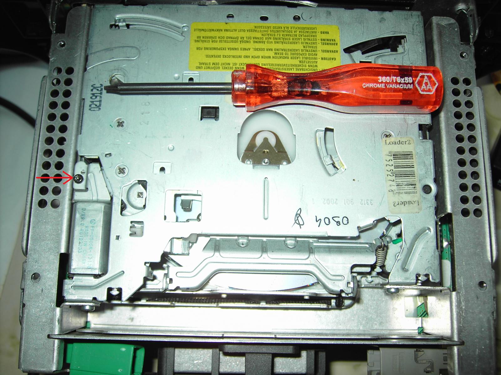

To remove a stuck CD, you need to remove the CN+ from the car and take off the top cover, then remove the screw holding the eject motor. You'll need a T6 screwdriver for the screw.
Lift the motor up just enough so you can get a finger on the edge of the white plastic gear wheel (arrowed red) then turn the gear wheel clockwise until the CD comes out.
As you turn the gear wheel, the metal tab (arrowed yellow) should move to the left and the CD should start to come out. You can only turn the gear wheel a small amount at a time, so each time you need to release it, hold the tab so it doesn't spring back then turn the gear wheel a bit more until the CD is out.
The wire and crocodile clip in my photo is not an electrical connection, it's just my method of holding the motor out of the way to get a finger on the gear wheel.
