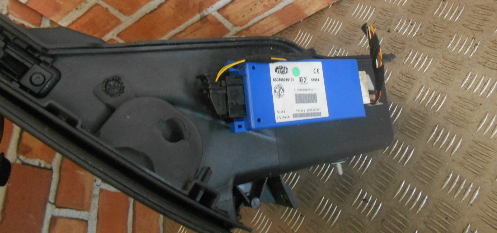

when i get back from holiday - i will be looking through elearn etc to see where the module is located.
It's the blue box attached to the side of the lower glove box. You may need to remove the glove box to get to it.
