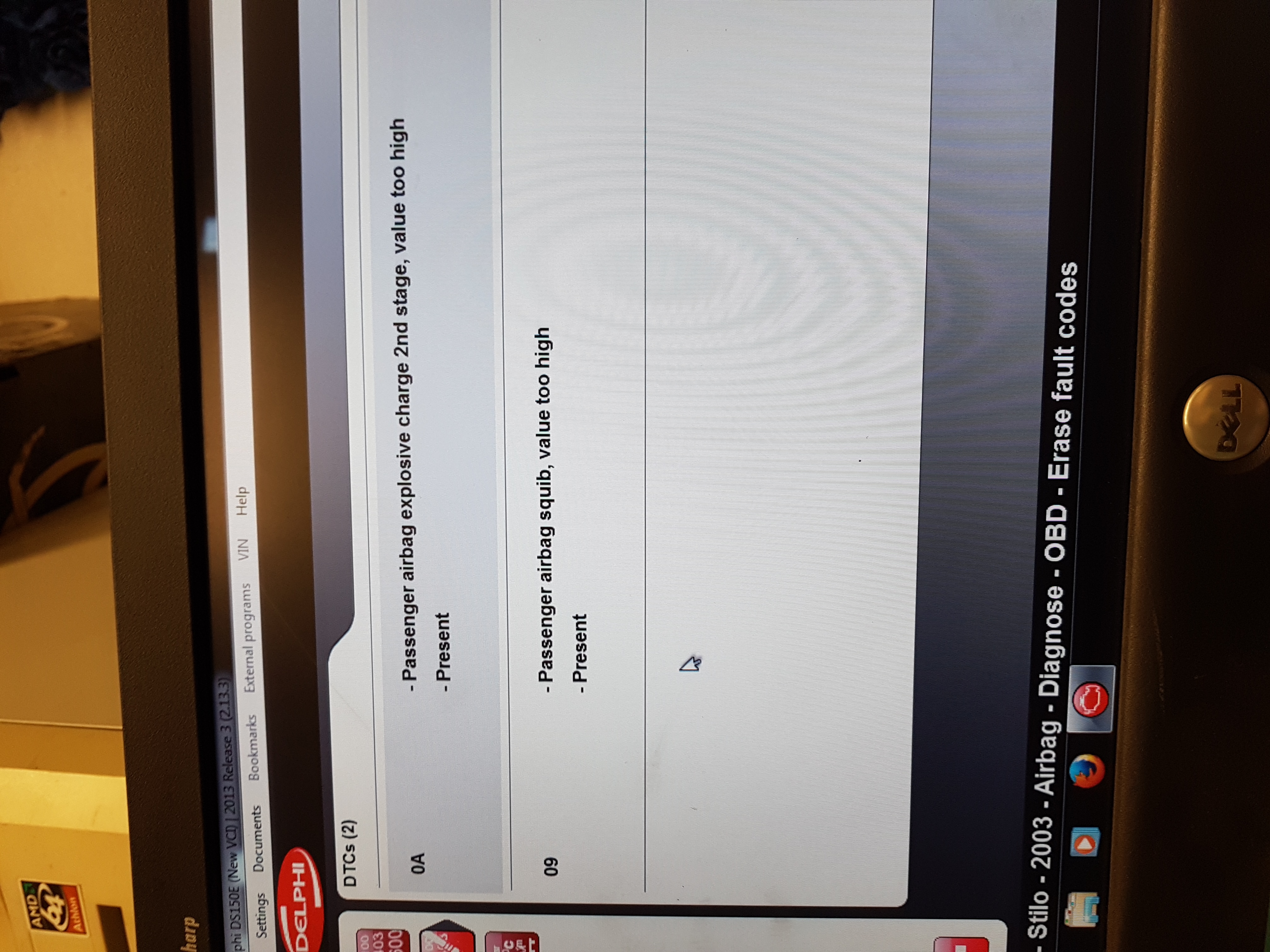

I figured i must have displaced clock spring somehow so i used a guide to recenter it but it didn't help. A buddy of mine used tester to delete a few error but "09" and "0a" remained.
http://imgur.com/a/Y0HX4
After searching forum for codes i found:

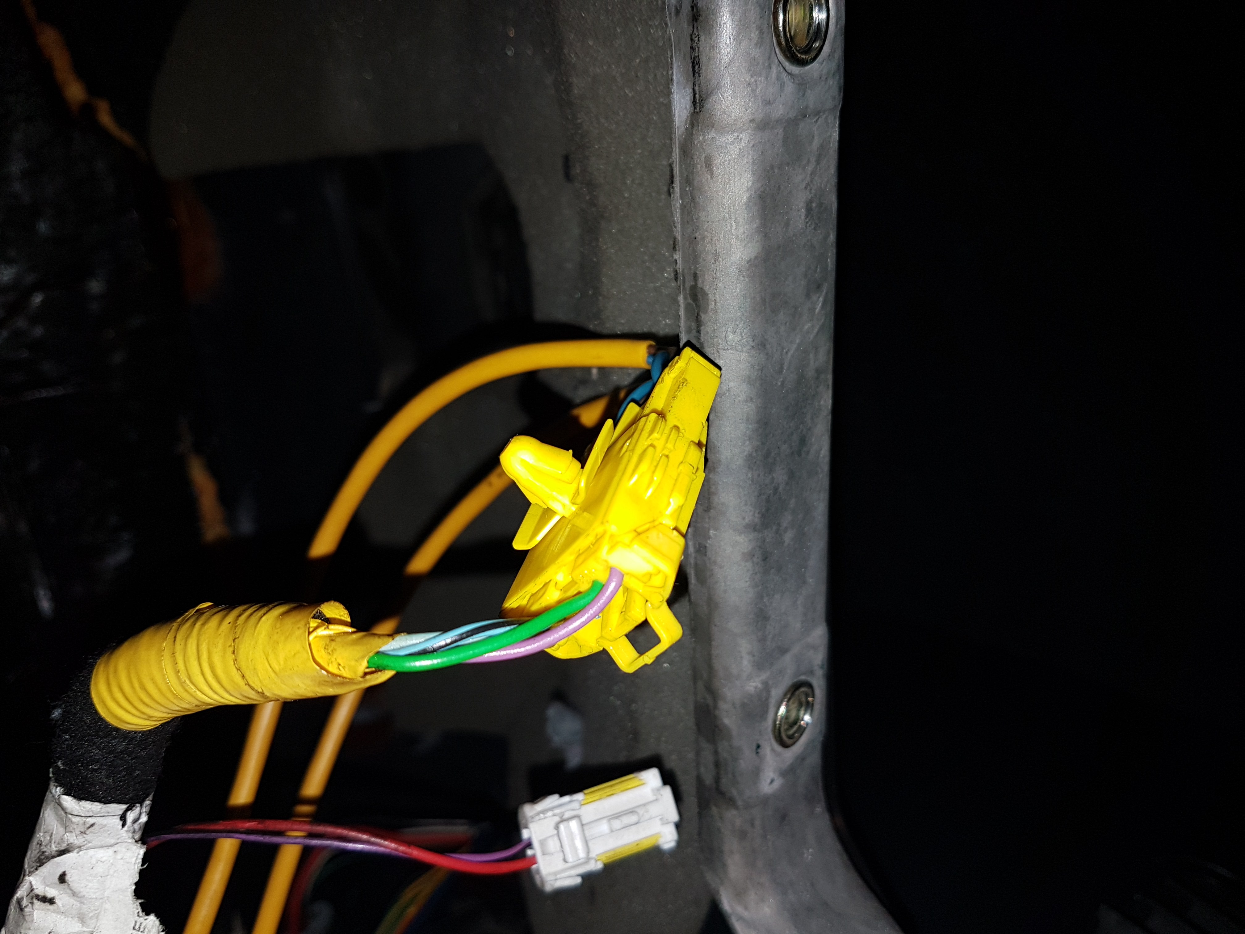

Yellow connector in glovebox - cleared -
09 Passenger squib circuit error 98
0A Middle passenger airbag squib 2nd stage error 114
so i cleaned connector near glove box using contact cleaner but the problem is still there.
http://imgur.com/a/6KvWn

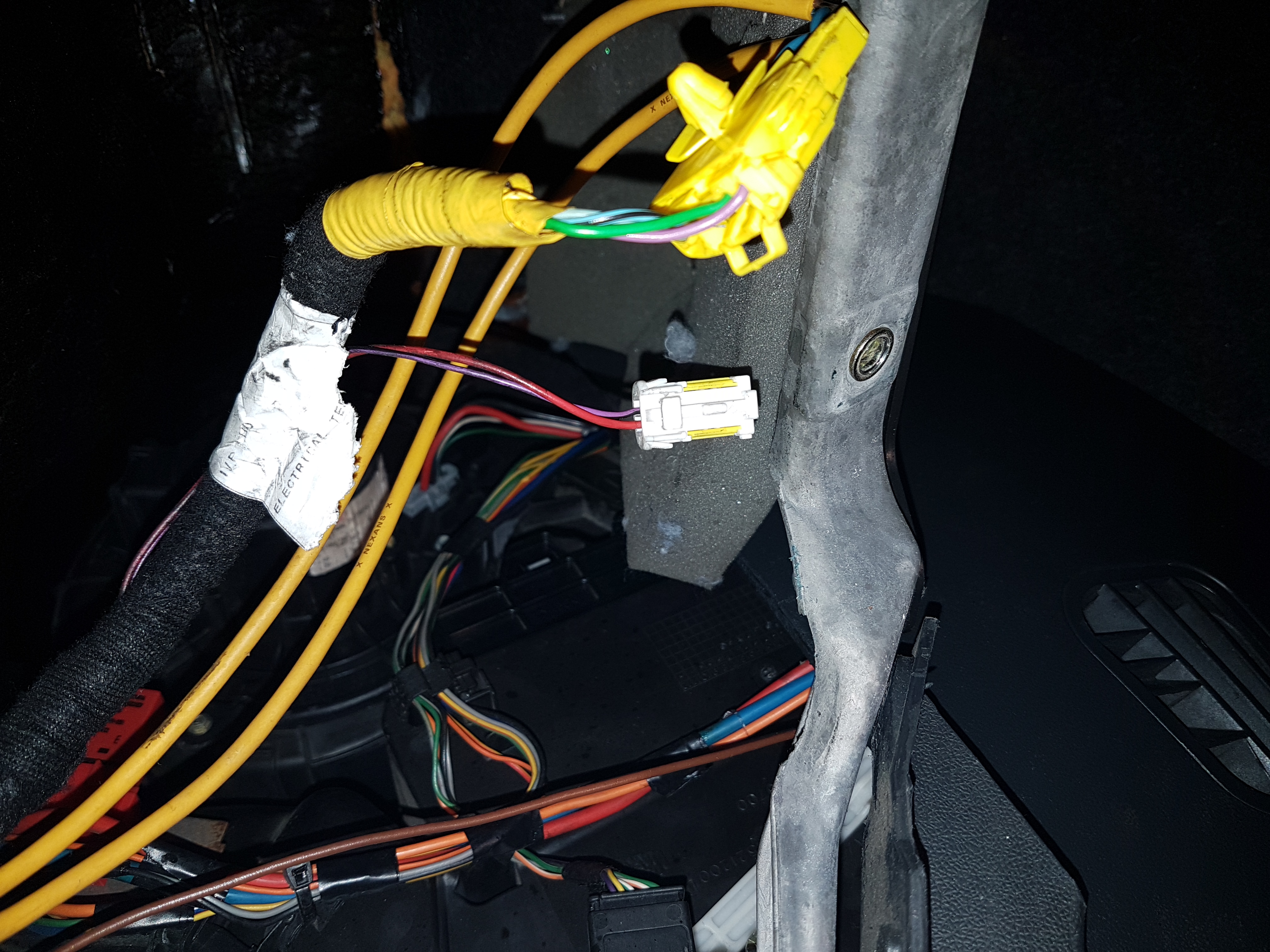

While cleaning i also found connector with no home.
http://imgur.com/a/zyl3S
I would like to know how do i determine which airbag is the problem since codes aren't pointing out the steering wheel one (i think) and if there is a solution that doesn't cost me a fortune.

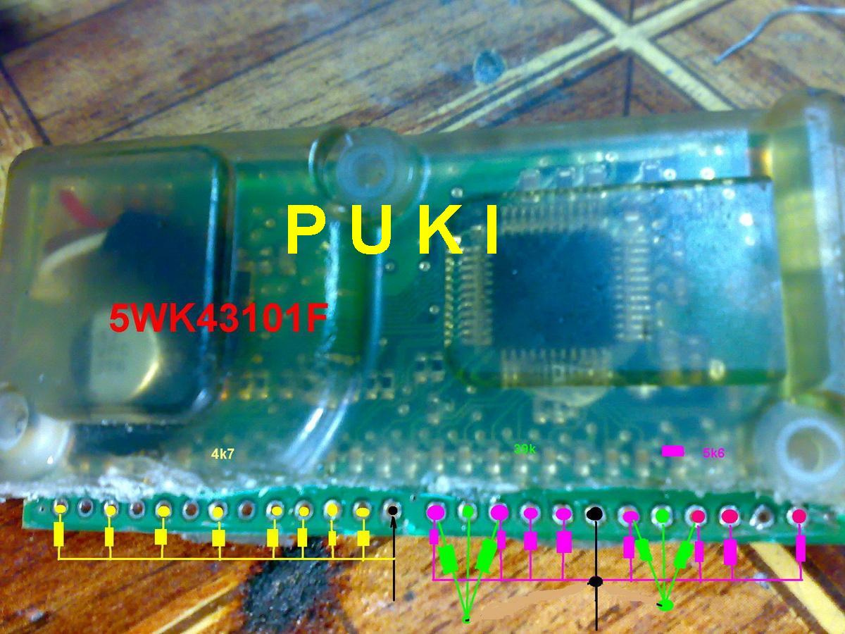

While checking passenger seat airbag I've noticed that it's already been worked on. Looks like previous owner built some kind of "resistor circuit" to emulate airbag sensor. After searching online I found "circuit" scheme which I included in attachments. I'm not sure if this is the same thing as in my car (2003 jtd 85kw) but it looks very similar.
