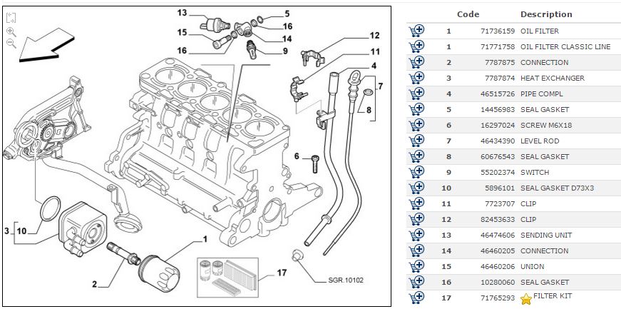

I buyed one Stilo Abarth 2.4 20V, and I needed to change completely the wiring and ECU due to a short into the system. Now after a couple of months, the car runs great, but I lost the Abarth oil Gauges at LCD. The pressure and oil temperature. I did a search here, and I didnt find nothing about it.
Basically I cant find the pressure sensor and his connector, and I found the temperature sensor that go into the oil sump, but I can't find the connector.

The oil pressure gauge sensor is item 13 in the first diagram below. The oil temperature gauge sensor is item 12 in the second diagram. The low oil pressure warning light switch is item 9 in the first diagram.
The connectors should be close to the sensors.

Good Day Davren!
This is exactly what im looking for! Now I ll do a very close ispection, into the engine bay, to try to find the connectors! And.. Now! hahaha
