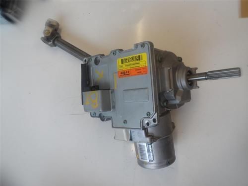

Can you just replace the motor or do you have to do the full unit? Then get it re coded apparently?
The motor is supplied as a complete unit as shown in the picture below.
