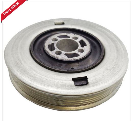

Mine (55096301) looks slightly different as in the picture... but the only other pulley for a JTD is 55190424 (which looks more like yours) but the Gates TVD1013 is the replacement for both types, so I don't know what the actual difference is.
Is your motor a 16V? That has an aux belt that should be 1360mm, even though the pulley is the same 55096301. The 8v's (even the 85bhp) had the 55096301 pulley and a 1270mm belt, when A/C was fitted.
You'll probably need a new pulley (avoid Gates this time, although they usually make good components). Try to get one that looks like the picture, without the cover plate, since it could be that which is making the clattering noise.

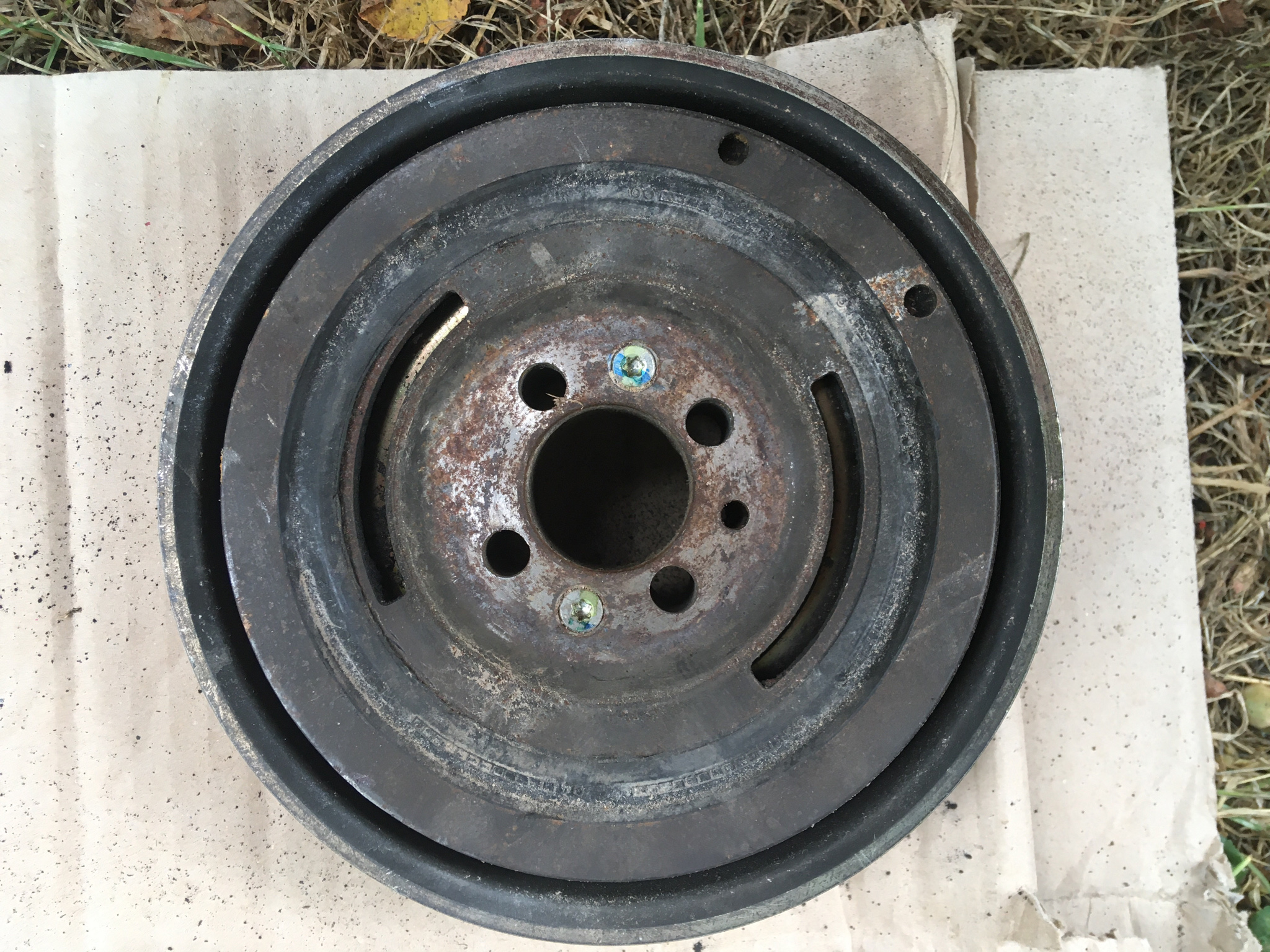

Ralph yes the gates one I bought last year is a different design to the original. I pulled out the old to show in pic below. It was propa shagged.
The gates one I bought last year seems to be a bit odd on further inspection. The second outer rubber (which is not visible) seems to be off centre, when I pull hard bracing it in my hand it’s comes back to an off centre position. I checked the motor running without it one, the shaft itself spins nice and cantered.
So it looks like either this gates pulley is, yet again, failing too quickly. Or I’ve done something wrong. I mean last year after only 2 weeks a previous pulley failed, then the replacement (warranty) worked for over a year to now. I’m thinking I’ll find an original Stilo pulley from a broken car at this point. One that looks exactly like mine. I know it might not run that long (though these are surely good for big mileage) but it’ll at least be a sure test.
If my tensioner is too loose I don’t see how it can wreck the pulley. And I just don’t see anything that has made the belt tighter. When it’s all assembled I can just about live the tensioner when pulling down on the top stretch of the belt (between alt and water pump).

The main difference is the other side. The outer rubber is tough and leaves a spring gap enough to resist the clacking I’m getting on the gates one. I’m really surprised by this difference since the force from the belt is obviously not centred and will force the pulley constantly in a non symmetrical spin.

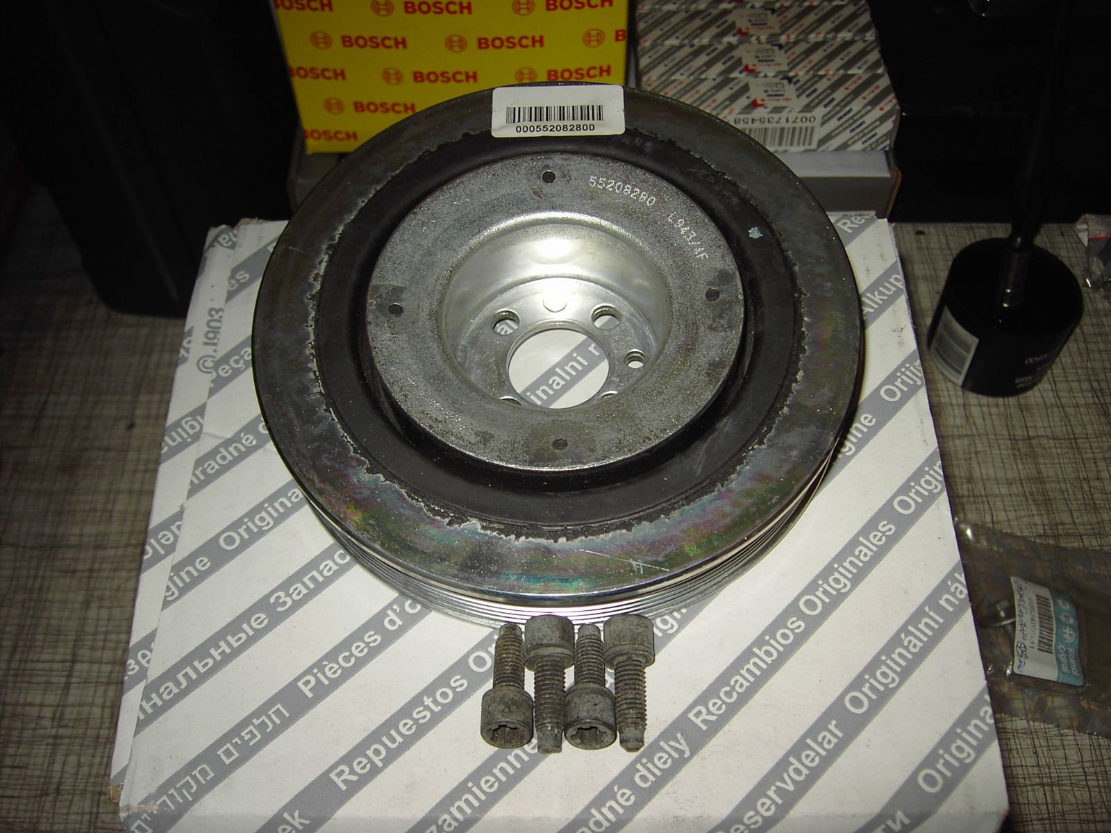

Right I managed to get another pulley in a rush from a breakers. The idea was to get an original Fiat part but the damn thing was a Bayko with same build as my Gates. I really don't want to throw too much money at this since I still don't bloody know what the cause is.
I'm going to hunt around for an original Fiat part that's in good nick. They're easy to check, just squeeze the inner ring outward to the outer ring and see if you can hear metal grinding (the current effect of by bust Gates pulley) which becomes the clacking or tapping sound once mounted (since tension on the pulley is only from the bottom and as Ralph says it's tight then loose then tight then...etc.)

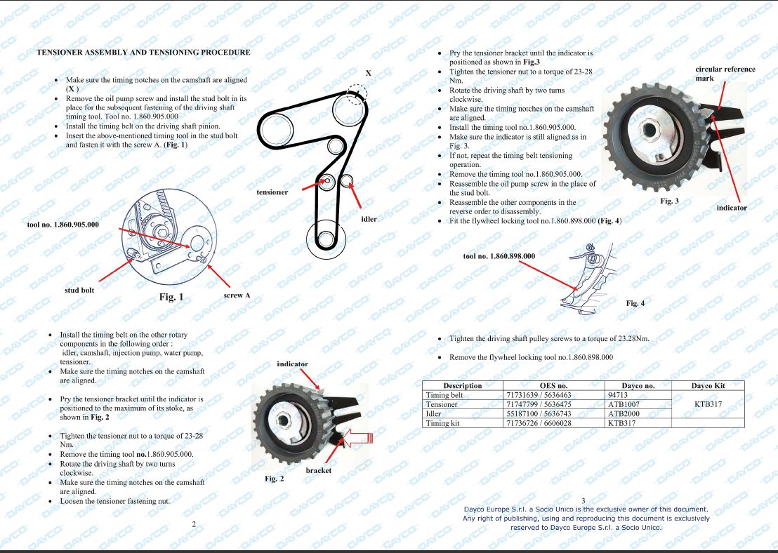

One thing I can't find that would help, anyone have a diagram of the whole setup so I can check the positions of each part - JTD 2002 1.9 115hp ?
Not sure what setup diagram you want. Any of this any use?

Thanks Davren. Yes that helps. The last one especially. Though mine is not a v8, it’s the same setup bar the top pulley.

I’ve also added a picture of the three pulleys I have. You can see the original one took a lot of punishment before going. It’s outer rubber looks way tougher and lore convincing the man the Gates (#2) and Dayco (#3) ones.
