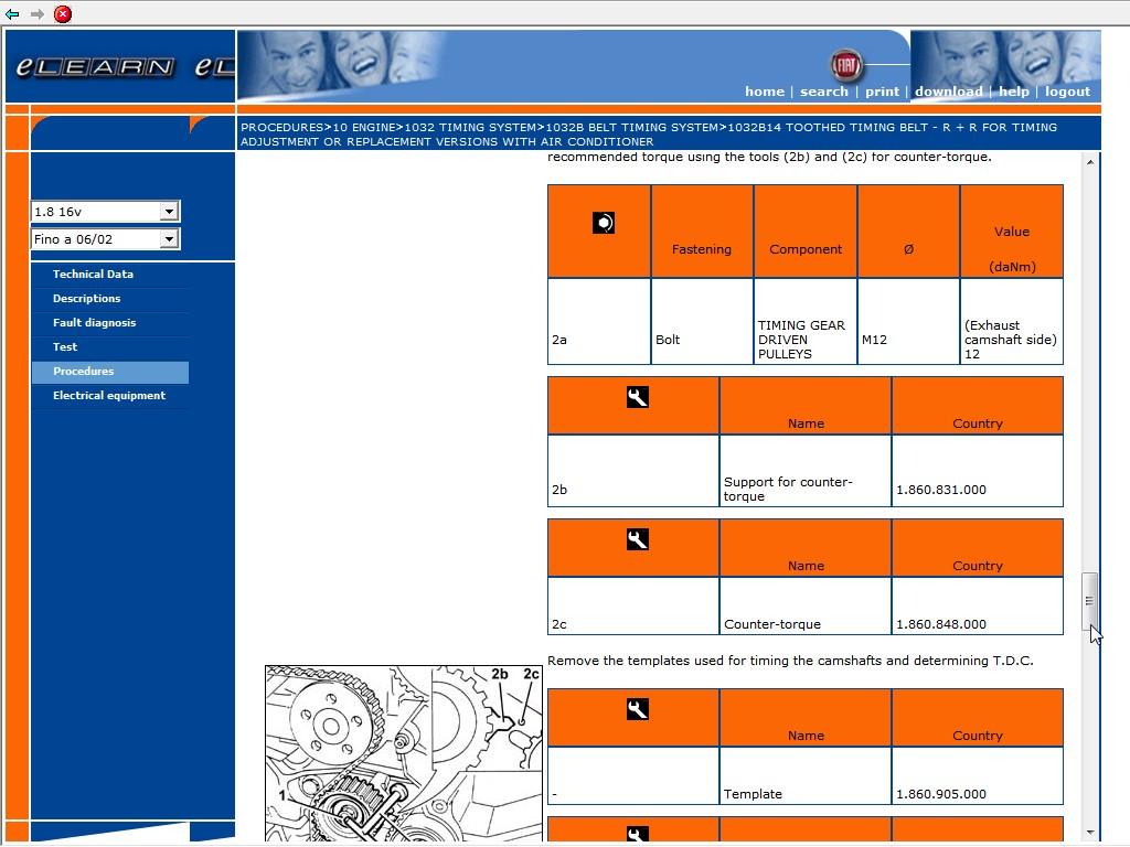

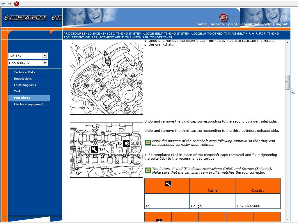

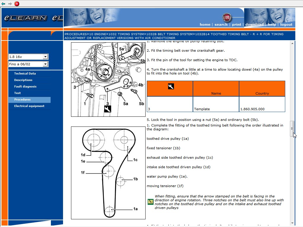

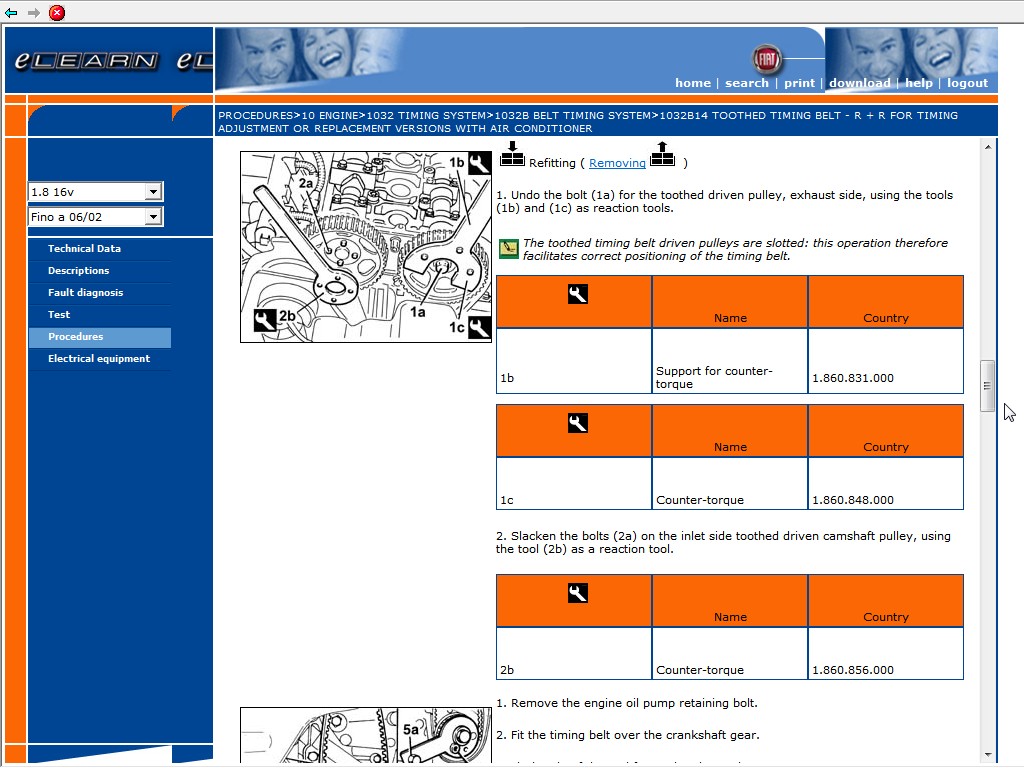

From manual:
Thank you Ashiuta for the pics and info that will be really helpful. Much obliged for your kindness. Burton Trent
I bought that Elearn manual yesterday, it had 25% discount with it, but am having trouble opening it up with the software from Oracle. I have a young lad coming to help me open it. Then it all will be easy! Hopefully
