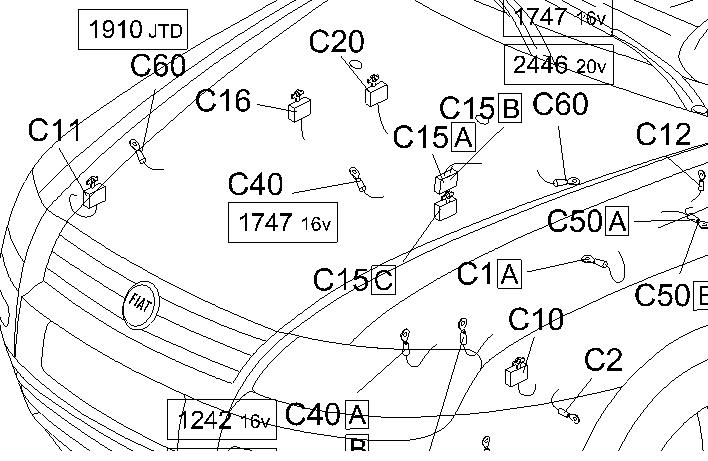

If the C10 earth is the one by the fusebox, up and right from the battery (looking from the front of the car), where is C11 earth?
Should be on the oposite side, but I just cant find it?
Could anyone send a picture (not from the eLearn CD please)?
Thanks.
Access from underneath, very near the windscreen washer reservoir

Thanks very very much!!!!
I will try to access it this afternoon and do a bit of cleaning and stuff...
Thank you once again!
Once again, I am trully and completely amazed by the ability of FIAT's engineers to make things complicated.
It is just there as you said so, Decks - it took me good ten minutes to find it, but I didn't have enough time to totally dismantle everyting to gain access to C11. Definitelly during the upcoming weekend...

What I also wanted to check was te earthing of the schirm on senors K43 i K47. From my experience, bad schirming can explaine a lot of "unexplained" things. For that, I have to find C40B earth which is nowhere!!!!! I tried to find it this afternoon but it was nowhere... Maybe Mr. Giovanni decided to put in somwhere where one has to dismantle half of the stuff to gain access to it...
Or it was just blind me...
What I found was only one earth on the engine, just underneath the ECU and one the ECU.

Earth point C40 A/B is the one directly underneath the throttle body connector
I thought so, checked later last night at eLearn and concluded there was nothing else that could it...
