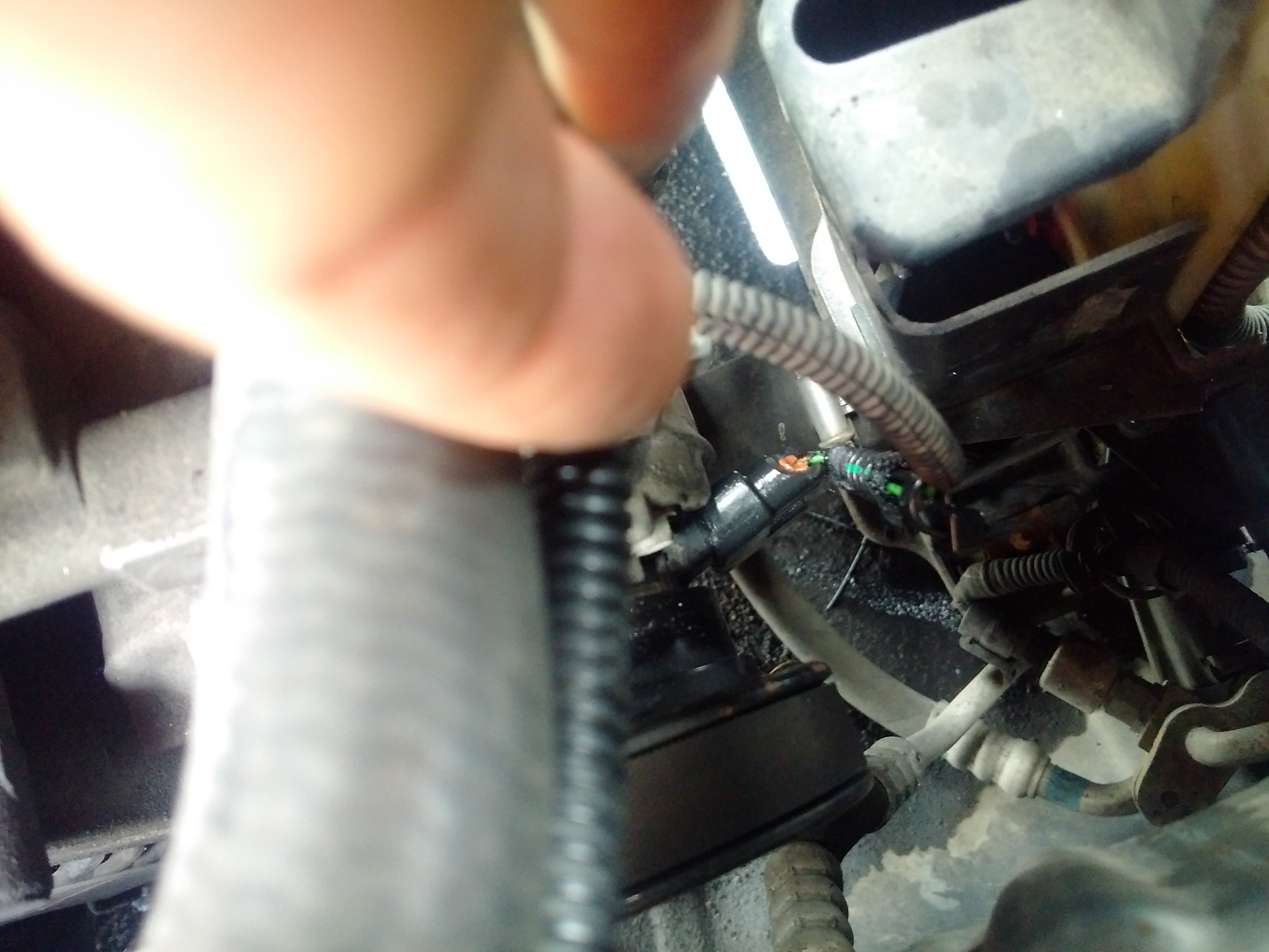

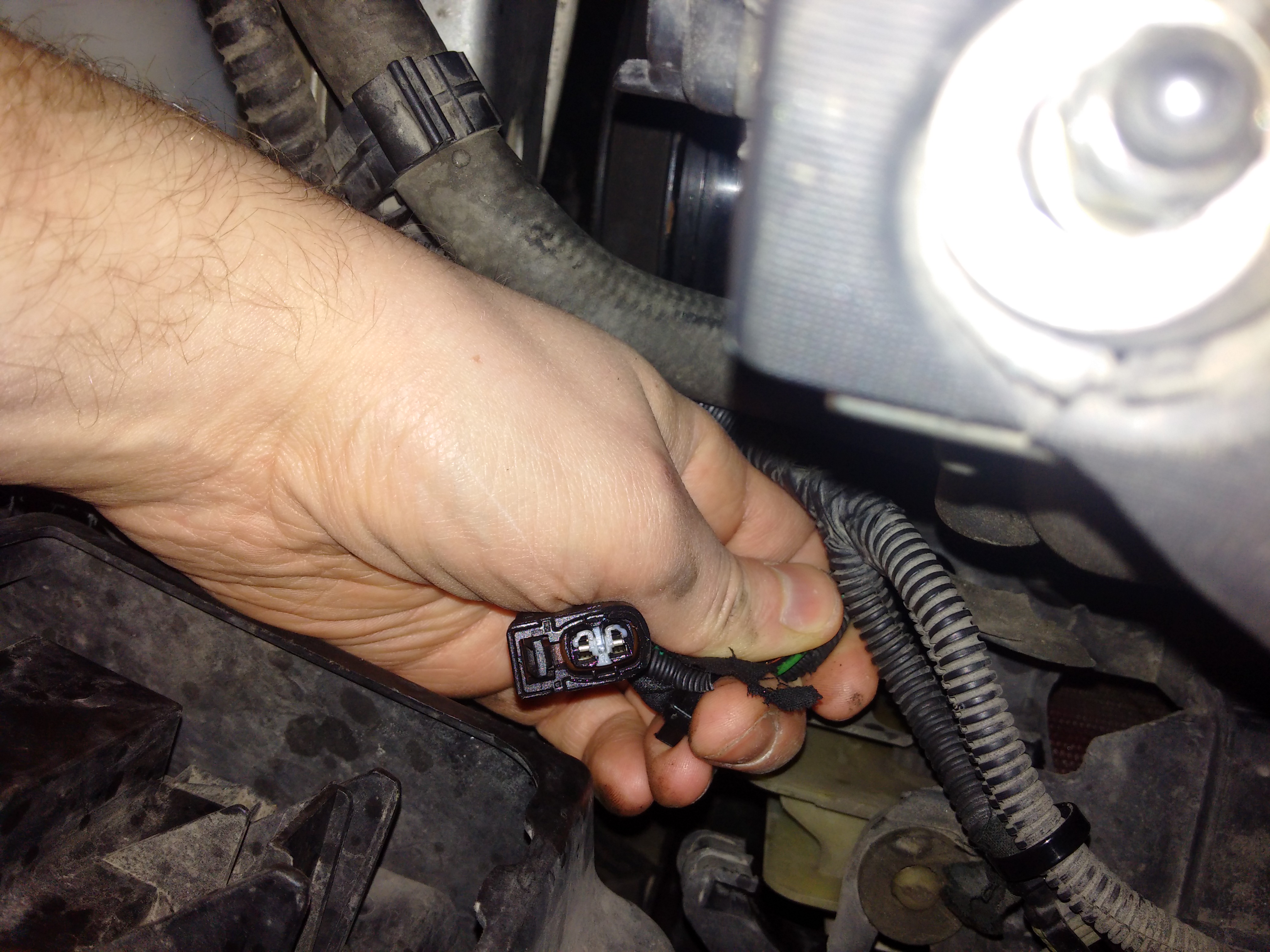

Hi,
My Stilo 1.6 shows me error code U1706 and lights up check engine, ABS, brakes, register plate light in panel. But car works just fine, engine works and brakes also. I have checked the battery and alternator, those are fine. But when checking wiring I found this wire or sensor in really bad shape: Check attachment WireSide and WireFront. It's located on left side of the engine front just near the belt (which has damaged the wire) check the attachment CarWireAttached2.
What wire is that? Earth or sensor or what? I appreciate all the help and advise how to replace it. Thank you

Thank you. It really was that one. It has been fixed now but unfortunately ABS, check engine etc still light up. Probably can't get rid of those ones. Main thing is that the car still works fine.
