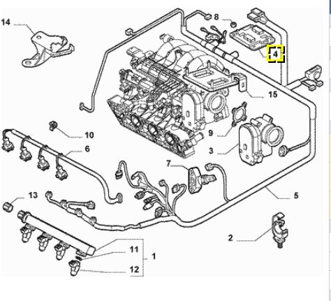

The sending unit will be a small black plastic assembly, usually attached to the top or the side of the throttle body, most often on the inlet manifold side of the TB.
It looks like it's number 7 in the attached image.
If you find yours, remove it and have a look inside it, you might see something that looks like a flap or rotary valve. Just clean anything that looks like it should move, so that it moves freely.
A new valve is £55-60 so be sure it's the valve before you buy a new one.. :D
If you can get hold of a second-hand one, then a straight swap should either solve the problem or improve things enough so that you know that the valve is causing some (if not all) of the problem.

Looking at the diagram, the sensor (number 7) looks like it bolts to the throttle body (number 3).. the diagrams aren't always 100% accurate but in this case, the TB seems to have holes in that would line up with the sensor.
You must have found it if you "disconnected" the TB...? In the old days a TB was just a butterfly valve with the accelerator cable attached to it.... so anything electronic on it is likely to be the sensor. Go onto eBay and search for "Fiat Stilo 1.4 throttle position sensor" and most of the results will be of the correct part, so you can see what it looks like.

It still looks like the TPS.
I've found some photos of a 1.4 TB on the internet but none of the photos show where the TPS goes, so you might be right that the TPS is not attached to the TB itself.
But it has to be in there somewhere, so you'll need to find it. If there is any electrical wiring leading to the TB or the inlet piping any side of it, with a rounded-rectangular plug on the end that will probably be it.
>>> Have you had a look on eBay for a Fiat Stilo 1.4 Throttle Position Sensor? You'll see photos of what the TPS looks like, to help you find it. It's about the size/shape shown in the ePER image (number 7) above.
The TB photos I have show a large plastic cover clipped onto one side of the TB (I'd guess it would be fitted facing the bulkhead). Is the TPS under that?
