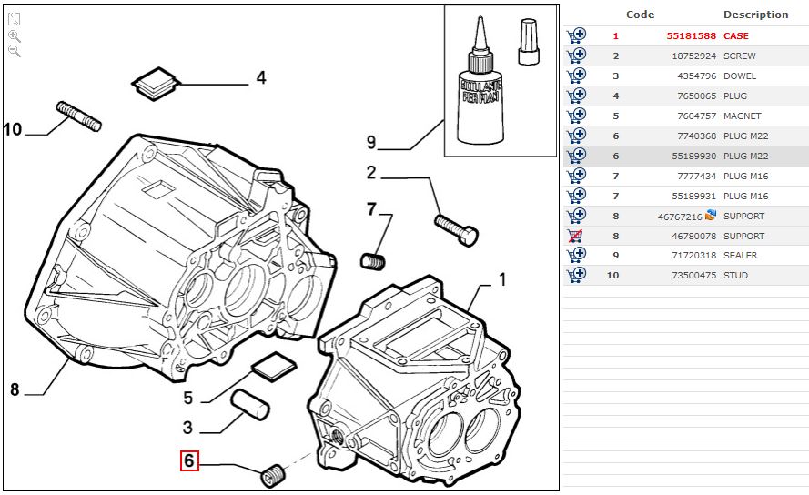

55181588 is the Fiat part number for just the rear gear casing.

Sorry.... I don't know. I believe the C.xxx or Cxxx refers to the general type of gearbox. The other numbers may refer to the gear and differential ratios in the gearbox, and whether it's 5 or 6 speed.
