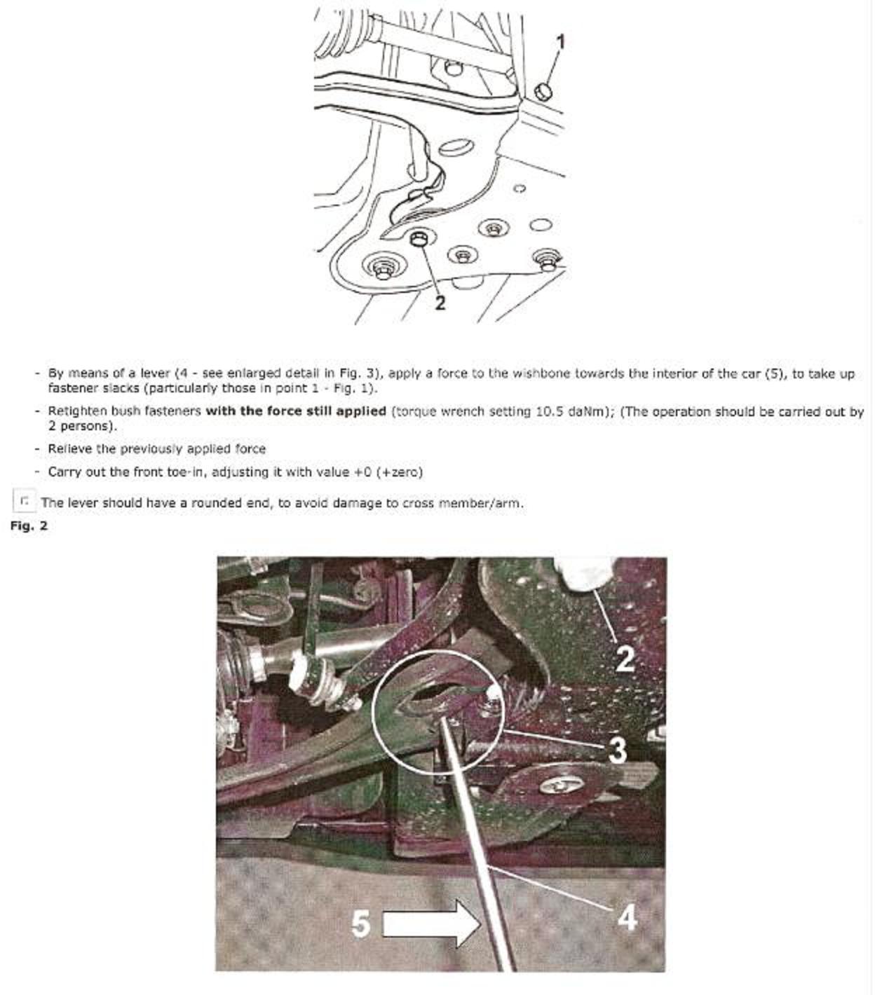

Also, your "after" figure for toe in shows -1.4°. Fiat used to specify -1° but changed it to 0° to prevent abnormal tyre wear. See page 2 of the Fiat Service News below.
