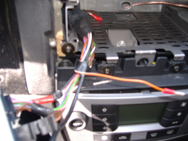

You have to wire up the amp control, normally its a blue wire on aftermarket HU. There should be a single orange wire that is not part of the normal stereo wiring loom, it should have a yellow plug on the end. That has to be connected the the blue wire.

Yes i'm sure, if there is power and no sound the amp's no connected.
This is the wire u need to connect to the amp remote wire. Its orange and wire. Not orange my bad.

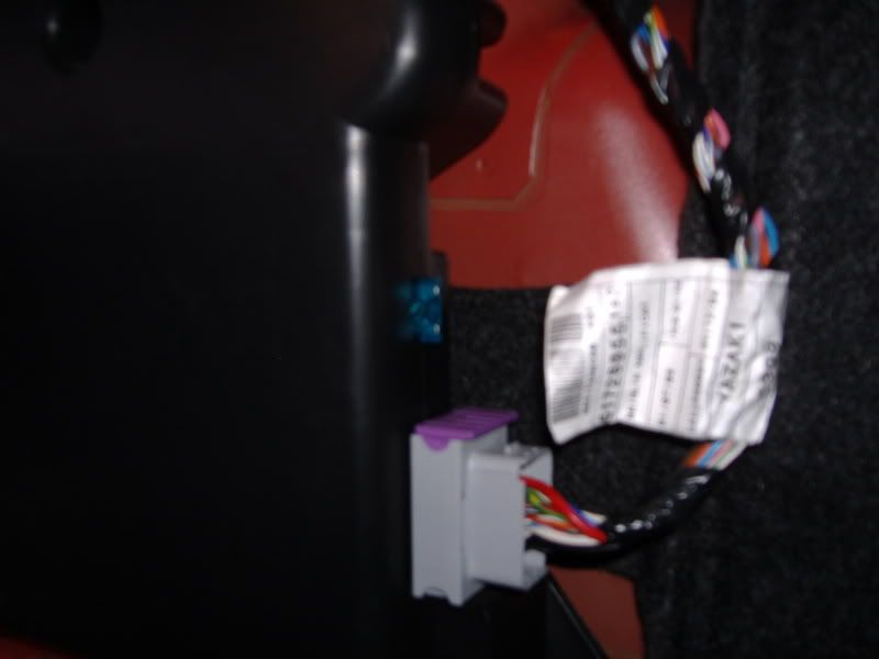

The amp is inside the sub box. The speaker wire's from the HU go to the sub in the boot, then from there to the speakers. Heres a pic of the multi plug that goes into the sub, with all the speaker wires going in the box then they come out using the same plug.
Sorry about the pictures they where just quick snaps.

located orange wire with yellow head (thanks Viggers!) Check!
turn on stereo...... sweet music to my ears!
