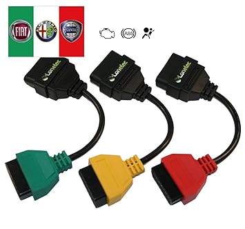

Many thanks, I have a 6$ OBDII scanner from Ebay but that doesn't seem to do the work. I'll try to get one from a friend that has a cable.
OBD is a standard for power units. The legislation did not extend to other vehicle systems, so manufacturers write their own languages to keep vehicles in the dealers. A standard OBD reader will not see steering problems. MES will.
I have one of those, from that company. Never managed to get it to communicate with mine, or any other vehicle.
I use an ELM (from scantool, as above) plus a set of coloured adaptor cables for the body and steering systems. Do a search for MES and find the threads with links to suitable cables.
Yes you'll need the green adapter and full version of MES. Standard OBDreader will probably only get into the engine ECU.
