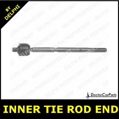

i need inner TIE ROD, the bit that looks like this.
What vectra part do i need to order for a 1.9 16v croma? thanks
I don't know a part number, but I do know that the garage that did mine just ordered the same part for a Vectra with the same engine and it fitted perfectly.
