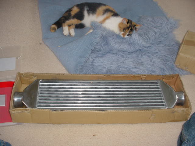

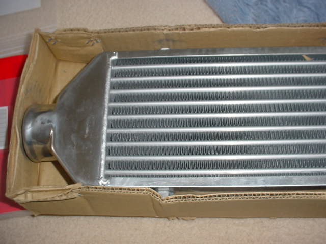

finally its here
wat u think
overal length is 28"
6.25 "high
2.5 "wide
o and do u like my cat

Looks capable of supporting 200bhp without any problems and small enough not to make a significant increase in lag.
Tom
ps I like your cat. lol
