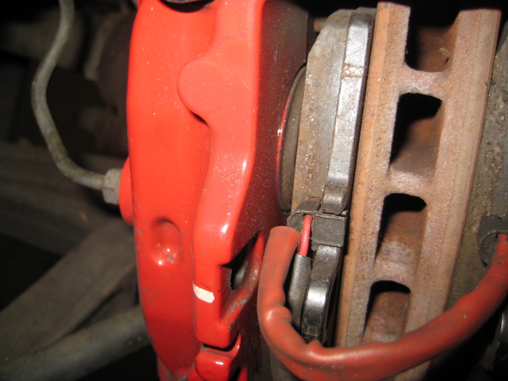

Ziggy
:eek:
hi end drivers often are more idiotic to start with....
Thats 1 damaged disc
Thats now 2x new discs and pads :) So great job spreading the wear
Dont you just wish - people who dont know what there doing didnt do it...
Ziggy
seen it myself
it was a private hire car, he came in saturday morning saying brakes squealing
he had hammered the pads in too
so nothing changes really
people just get more stupid i think
