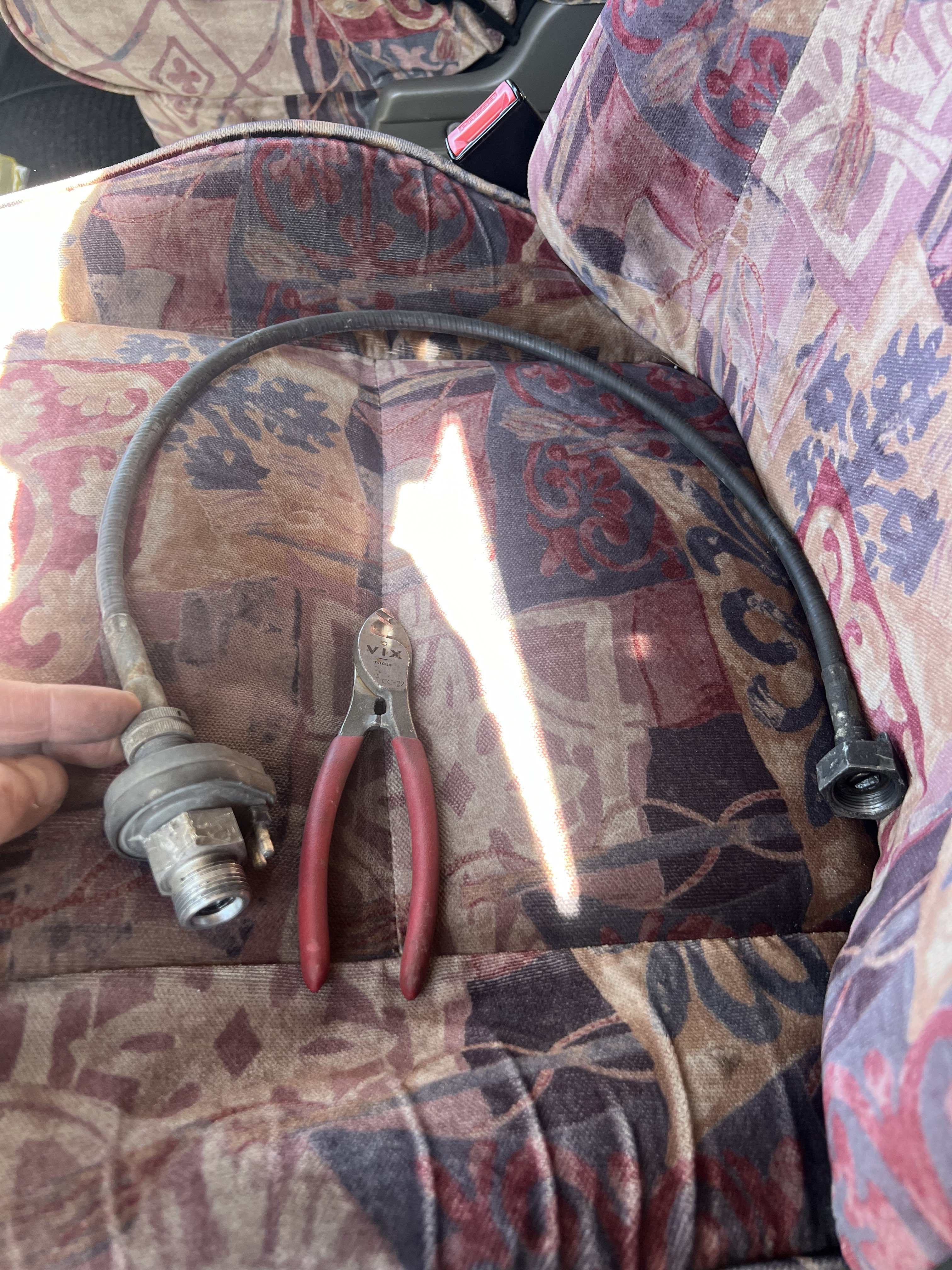

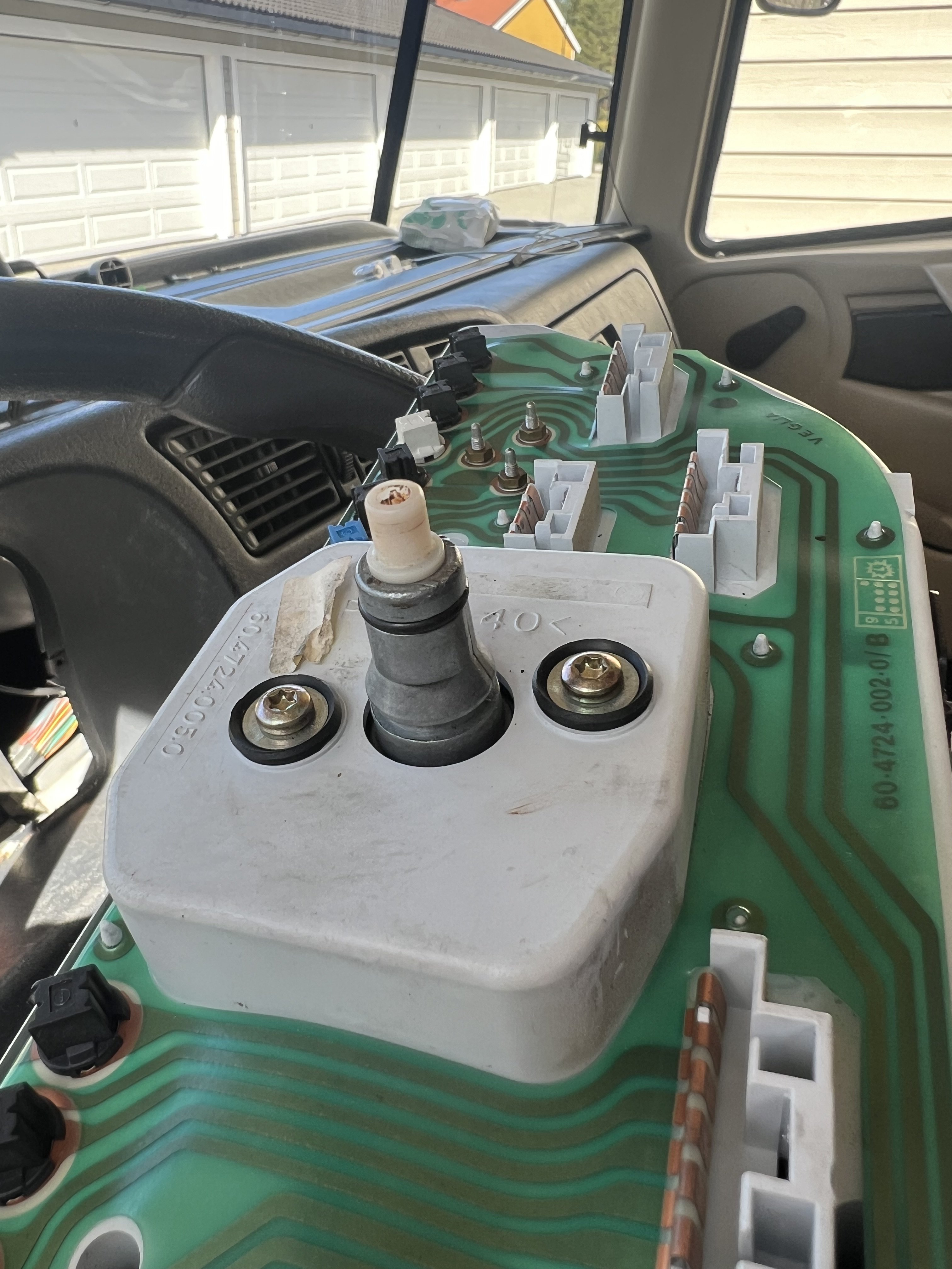

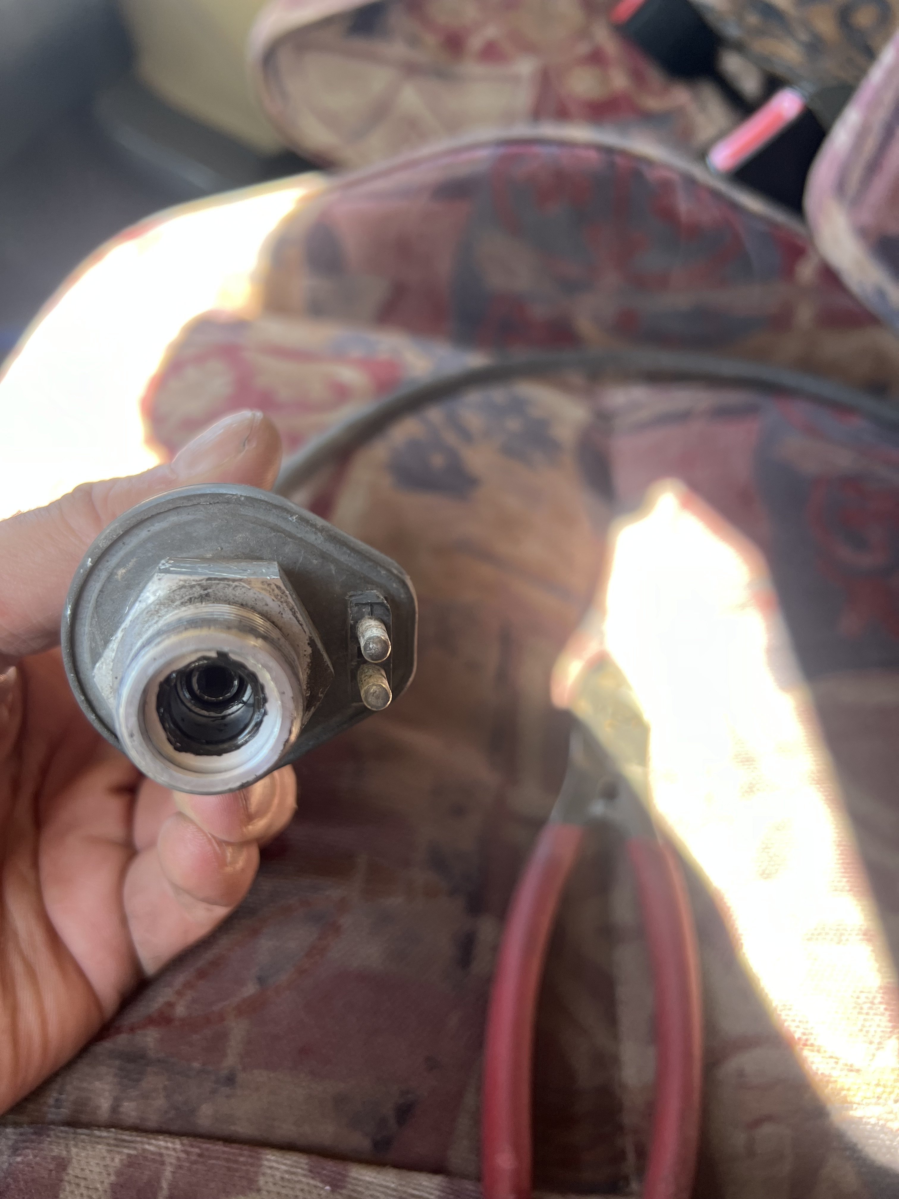

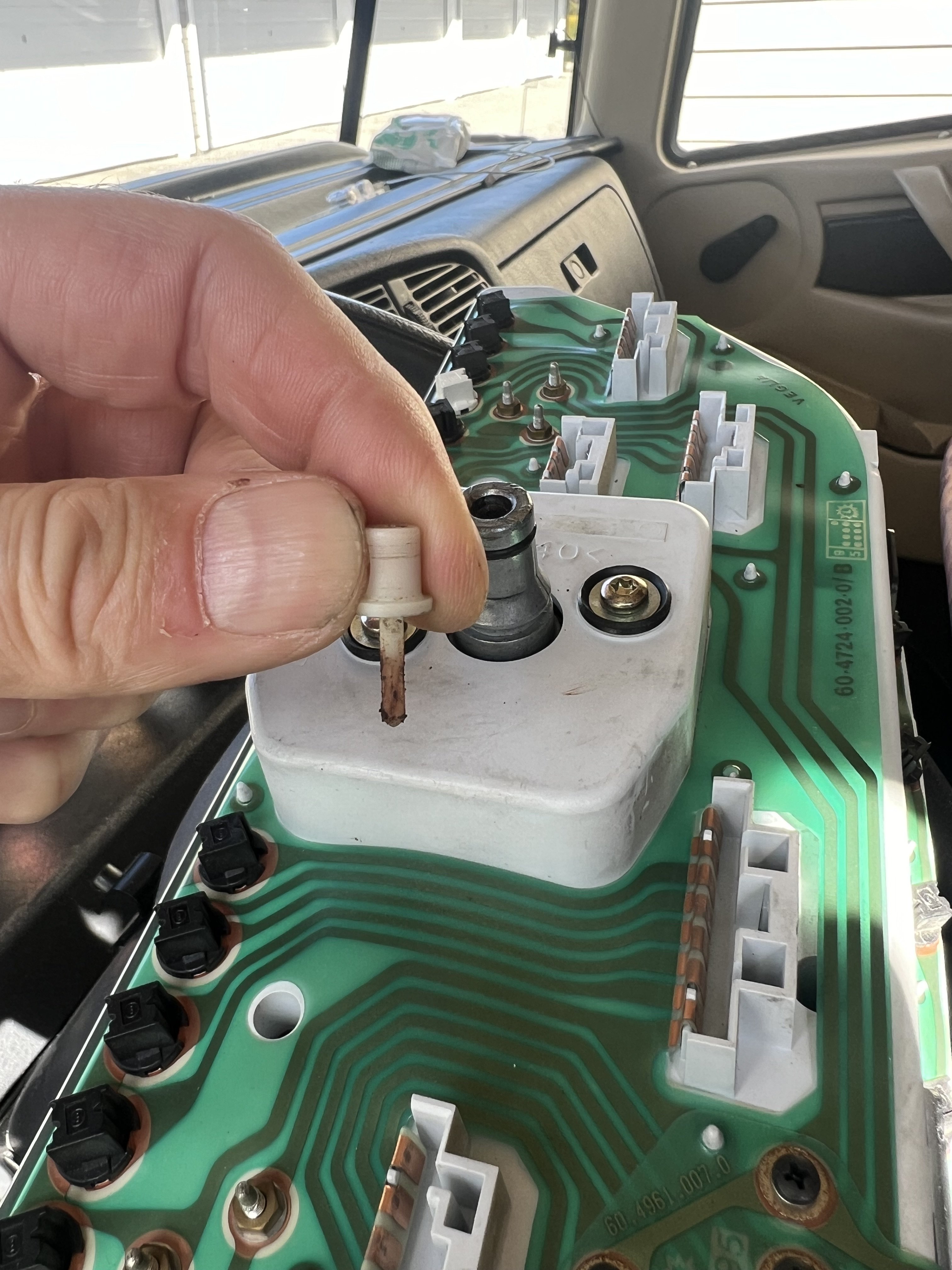

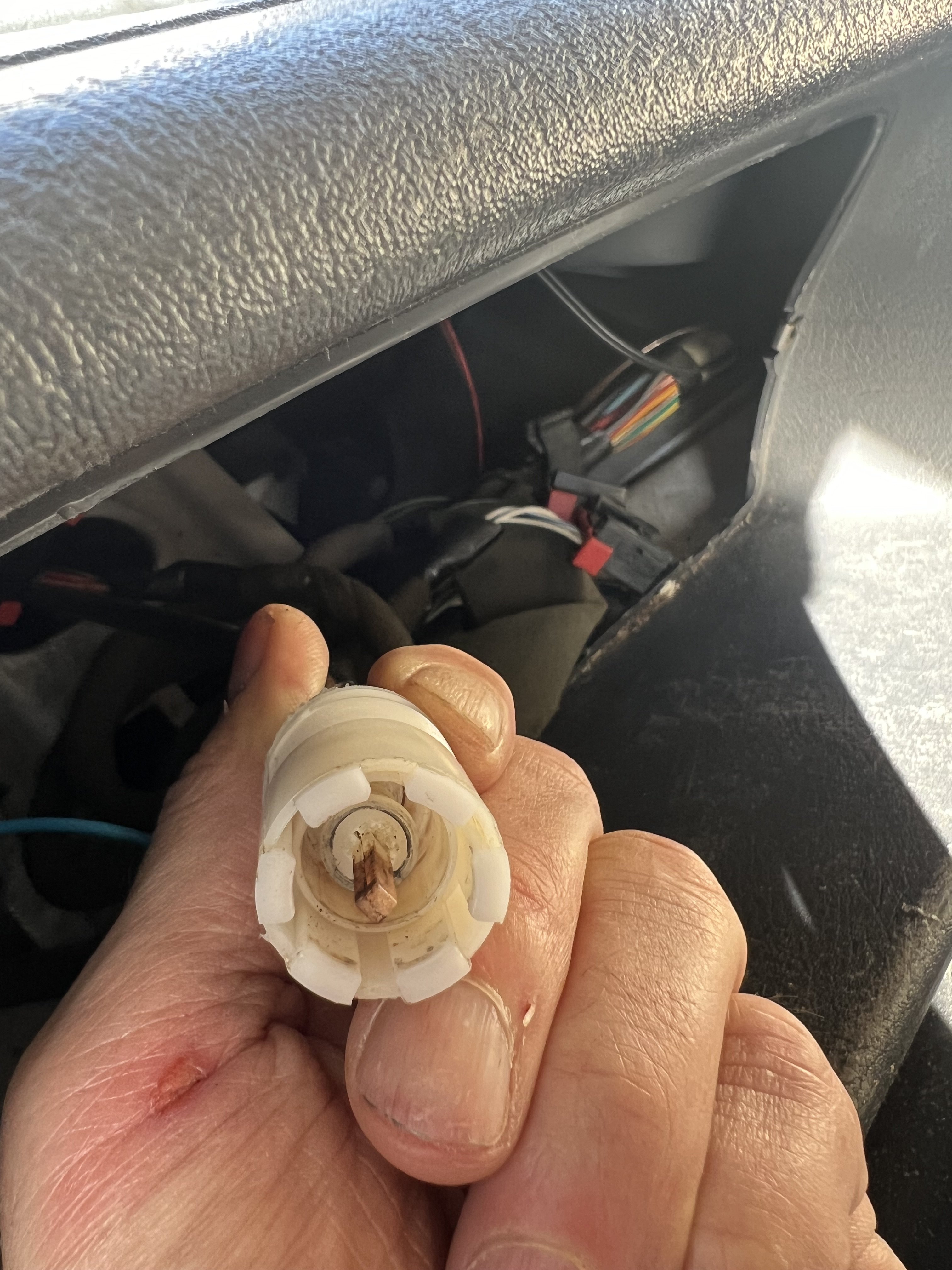

I disconnected the cable that was attached to the gearbox. Connected directly from the speedometer. Don't know what the cable in the gearbox is for. There were 2 wires connected to it. It improved but not completely. The speedometer needle still fluctuates slightly. However, I'm unsure about the connection of the cable to the speedometer. I bought a used speedometer and it came with a plastic sleeve that I didn't have on mine. I also can't attach the cable to the speedometer when using this plastic sleeve. Any ideas? I'll attach some pictures.

If you can connect your new cable directly to the gearbox, without tight bends, then that would make sense.
I am wondering whether the "gearbox cable" has been removed from an x230 fitted with a common rail engine., which would have beeded a sensor for road speed. Alternatively an aftermarket automatic reversing light switch (Why?) or trip computer.I do not have any thoughts about the plastic sleeve at the rear of the speedometer, but others may have met this.
Can you try your spare speedo to see if it gives a steady reading? Also you could use it as a learning aid , to check for damping mechanism.
Thank you for your response. Good theories. It's possible it could also be due to the need to monitor the vehicle's speed. An aftermarket cruise control was previously installed on this car. I'm increasingly inclined to believe it's related to the connection of the cable to the speedometer. I really don't understand how this sleeve could fit. Could there be multiple types of speedometer cables for this? I have tested both speedometers, with the same result. I need to get it through inspection. It's currently off the road:(

Cruise control most likely reason for extra drive cable and wires. Back to original problem, is speedometer input shaft free to rotate?
You mean inside the speedometer?. Yes, when I insert the plastic sleeve and rotate it with my fingers, it rotates smoothly and the speedometer needle jumps up.
