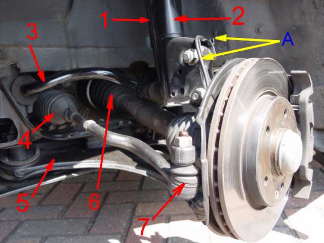

Turn your steering wheel as far as it will go to the left. Get out and look at the left front wheel. Running between the wheel hub (where the brake disc/calpers/shock absobers are attached) and the gearbox (the big metal lump attached to the side of the engine) you will see a thick metal shaft with a vaguely cone shaped flexible rubber "boot" on the end where it goes into the gearbox. This is the driveshaft, the fexible rubber thing being the boot referred to by rallycinq.
Hope this helps,
Dan.
Not off a Sei, but you get the idea.
Number 6 is what you're looking at.
Hope this clears things up a bit.
