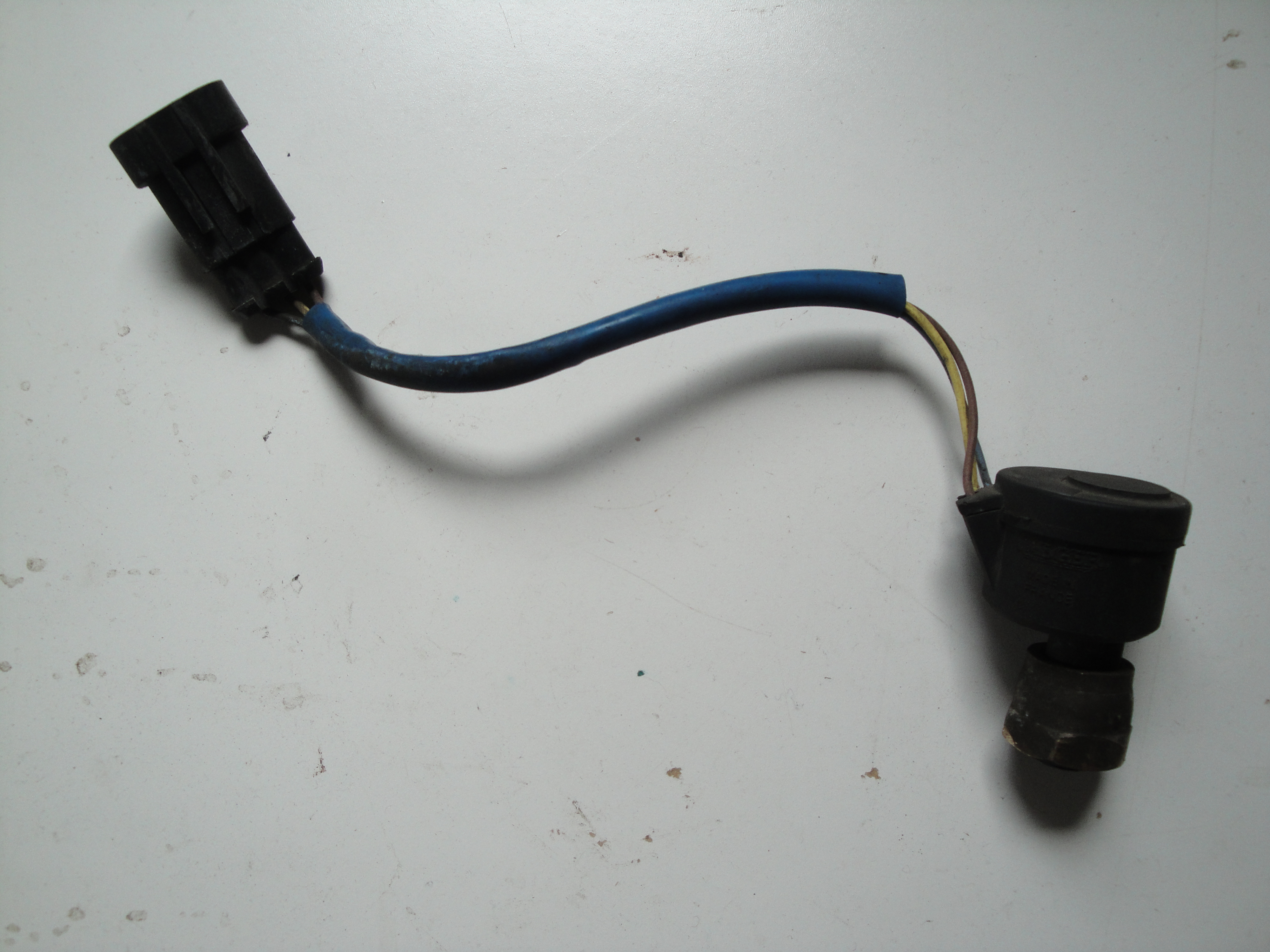

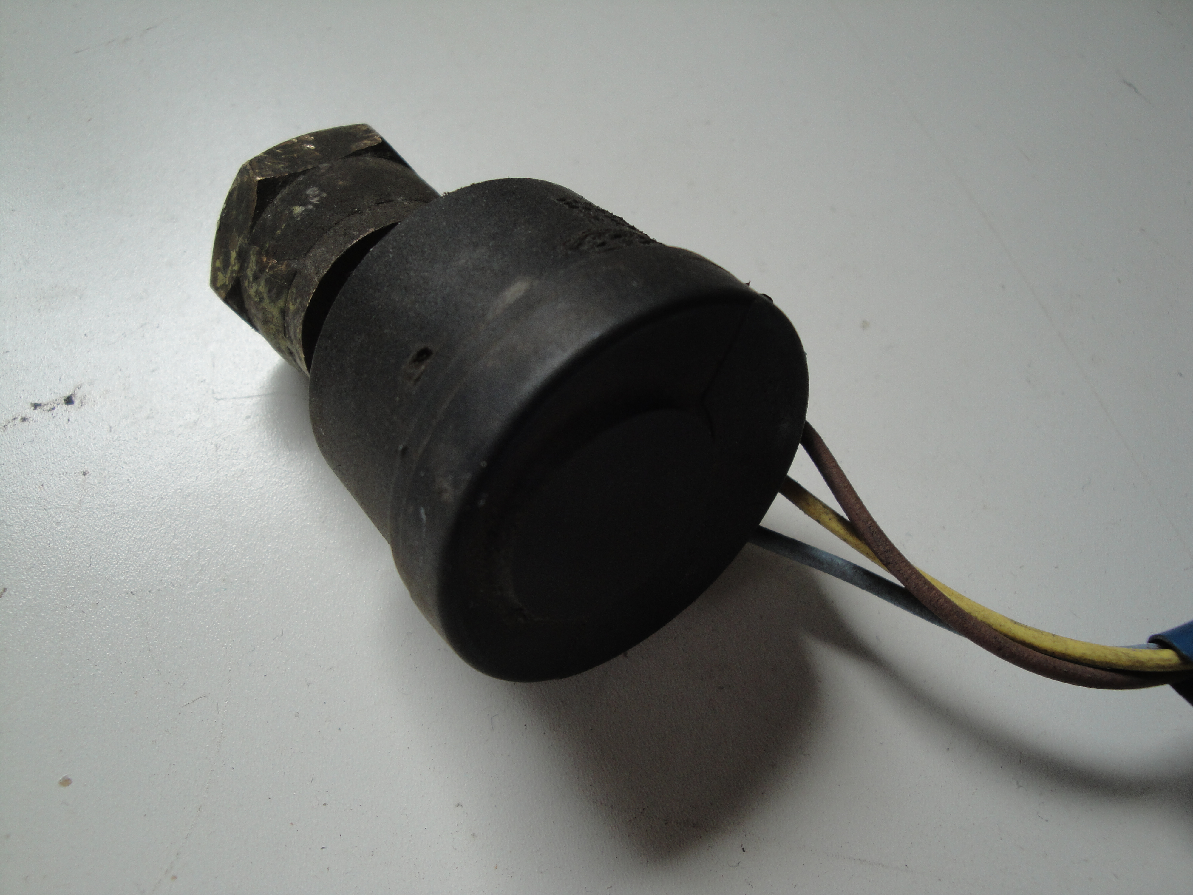

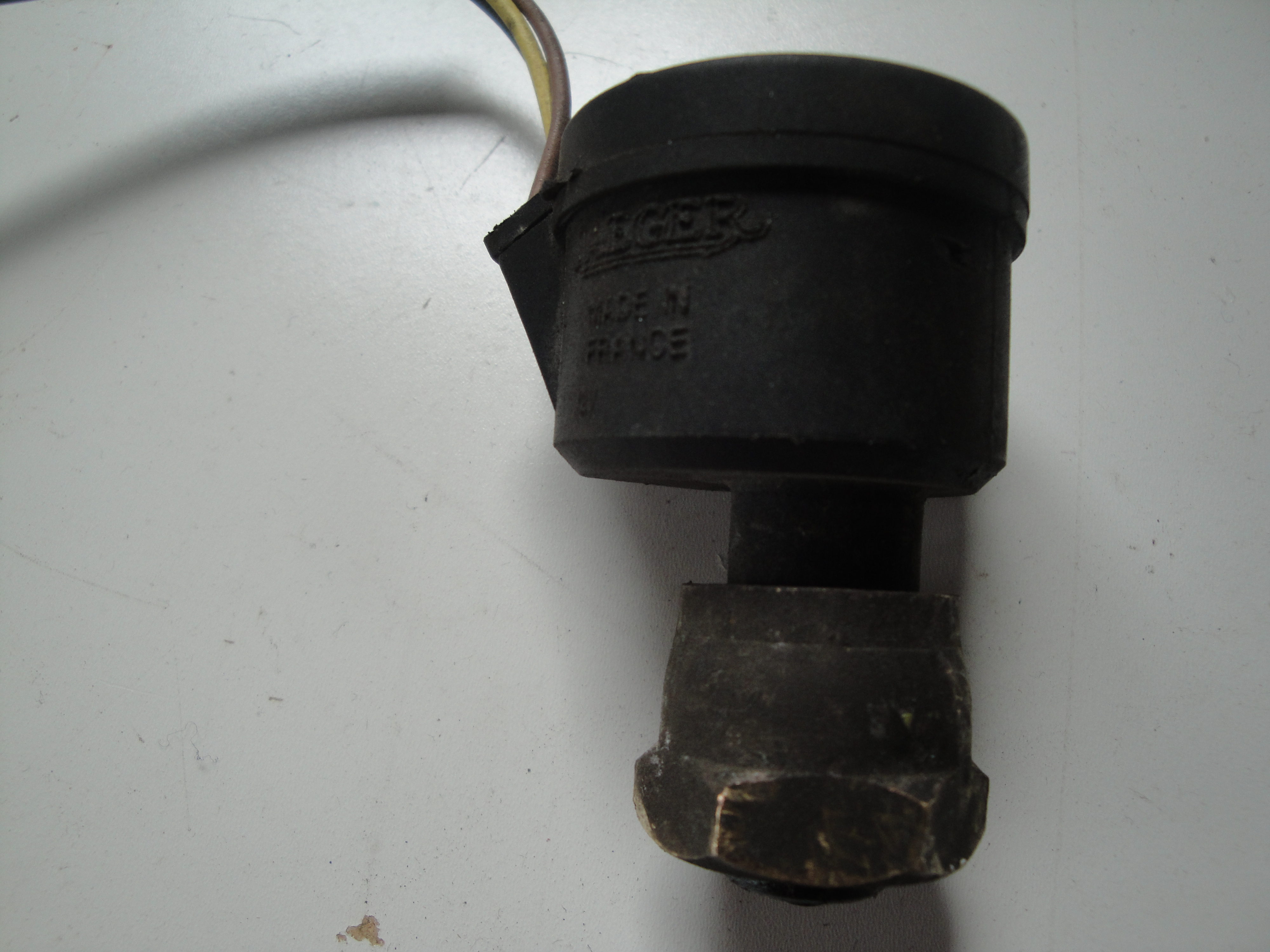

Cos I'm not the best internettist , I don't know how to attach pics to messages , so here is my speedo sensor removed from the car , wasn't too difficult , but it's always easier to undo stuff rather than tighten them up because you are looking at it from underneath .
Hope it's the same as yours .

My speedometer sensor is the same has Barchetta Bloke. these sensor were used up to chassis number 37640 part number 46403099 and are difficult to find. the second generation sensor part number 46466696 are readily available.
I've hit the dash etc, changed the speedometer twice for supposedly known good ones, re soldered as written about regularly to one unit. replaced the sensor without any improvement. leaves me to now believe (next job) that the part just inside of the gearbox as broken and will require long nose pliers to remove the lower broken part.
That VIN , according to the list here occurred in mid 1998 , so in theory won't be any good for the 2001 car
Yes 15/5/98 and then replaced again by part 46817374 on 15/10/2001.
My ignorance may show here but, as far as I can see, no other parts were changed as part of that modification so is there a reason why newer ones won't work?
