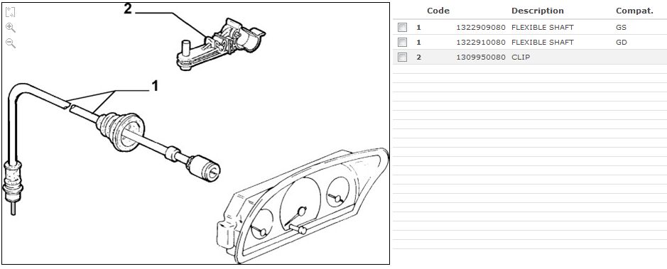

The parts catalogue shows 1 cable for RHD 1905cc vans and 1 for LHD 1905cc vans with normal speedometers.
There's a different cable if the van is RHD and has a tachograph fitted or 2 different cables if it has a tachograph and was produced for the French market.
In this diagram from the catalogue, GD is for RHD and GS is for LHD.

Thanks a million!
So glad i joined
You correctly identified the cable i needed and it now fits!

This is when i joinied the forum and discovered I did in fact have the correct cable
Discovered this as I went back to the garage and compaired numbers
At this point i sat down in the van with the old broken cable bits and the new cable (I know the garage owner so i was doing this at home) trying to fit it to the rear of the speedo
2 hours later i finally discovered what was wrong
The plastic endpiece of the old speedo inner wire had been jammed onto (you could not see this as the parts were inside the plastic barrel of the new cable) the end of plastic endpiece of the new cable!!
Thus making the the assembly 10mm too long - hence it would not fit
