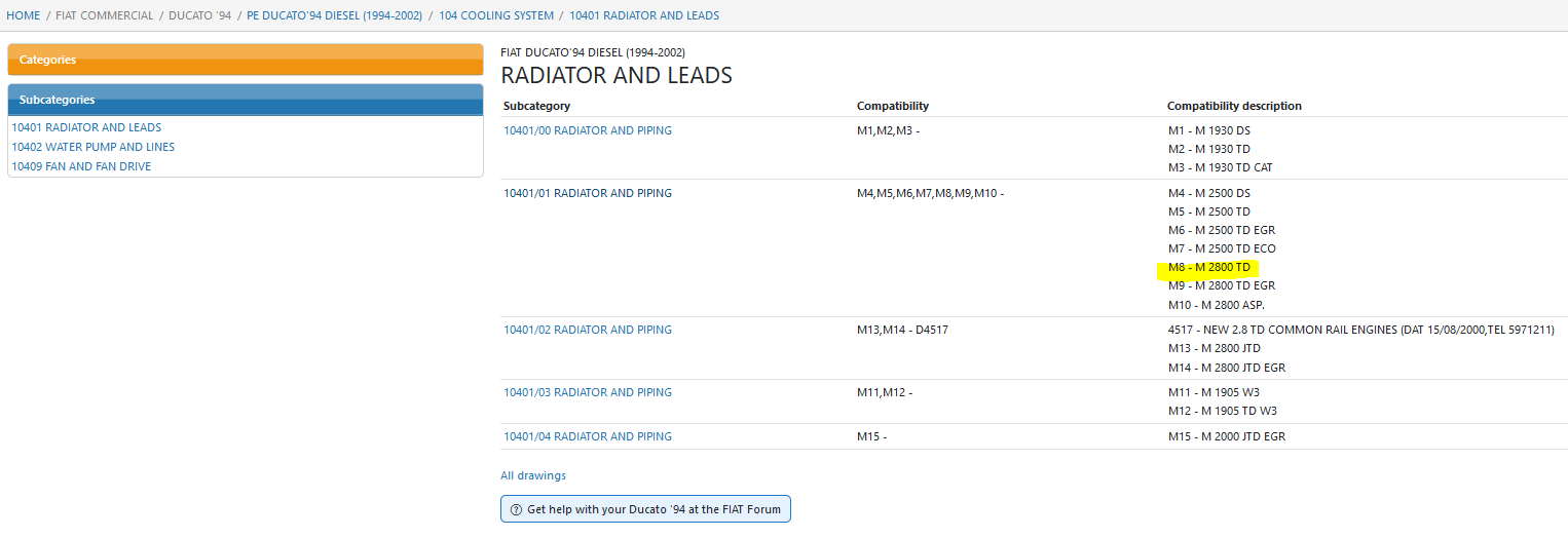

Hello,
PA6.6-GF30
is the composition of the plastic material on which you've found it: polyamid 66 with 30% of carbon fiber.
As for the radiator, according to what can be find in ePER with the information provided:
I assume it would be one of the 2 engines highlighted in yellow:
For the M8 engine:
For the D4517 engine:
E025 being the A/C.
Both remarks (C6528 / D6528) are 'Adaptation to Standard 2000/53/CE'.
You've got the links to the 3 products pages on ePER:
The weight differs from 7,2 to 9,2 kg. The question is what else is different.
I'd start by confirming which engine does your Ducato have.

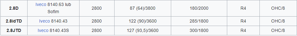

According to wikipedia, those were the 2,8 liter diesel engines available on the x244:
pre-lifting:
post-lifting:
And the facelifting was launched in 2002 I suppose, so perhaps the 'new' 4517 engine is marked with the N at the end of the engine symbol.
We need a x244 diesel specialist to confirm :D
pre-lifting:
post-lifting:
Confirm what exactly? Perhaps the designation of the 2.8jtd Power version with variable vane turbo as 8140.43N? These are comparitively rare, at least in the UK.
I suspect that due to the slightly higher output, the 8140.43N would merit a slightly larger radiator, or at least a radiator having a greater heat dissapation at operating temperature.

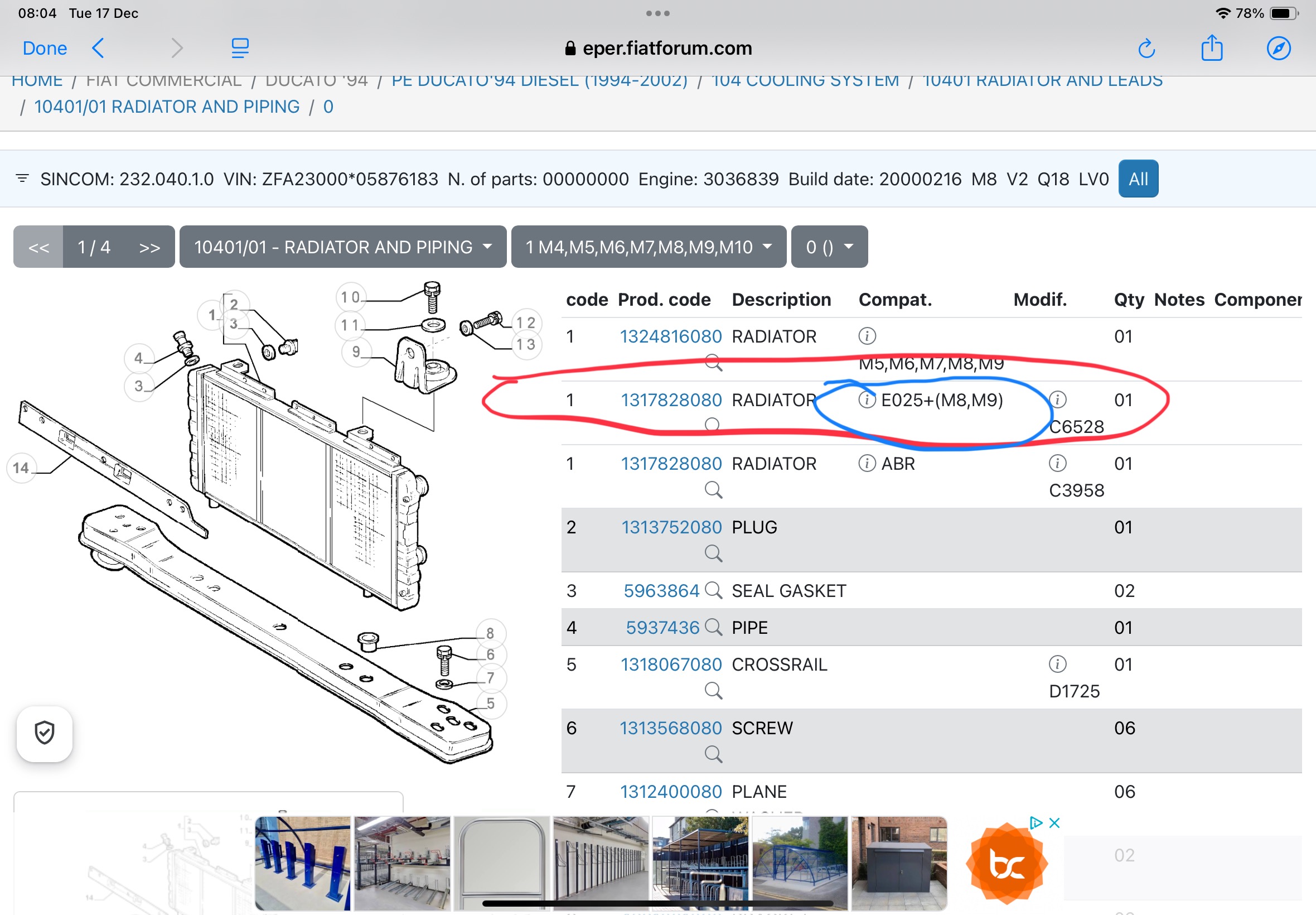

Well I’ve searched eper again but this time I’ve put astrix in chassis number ( I thought astrix was not important 😊) and got this
I think the radiator circled in red is probably mine , if blue means “with Aircon)

Yes, E025 means A/C. When you move the mouse over the circled i it will show an explanation.
And yes, M8 is the code of your engine as I thought at first :) So that's the 1st part number I've listed :) Happy you were able to confirm it ;)
Now you finally can spend your money on your FIAT :D
