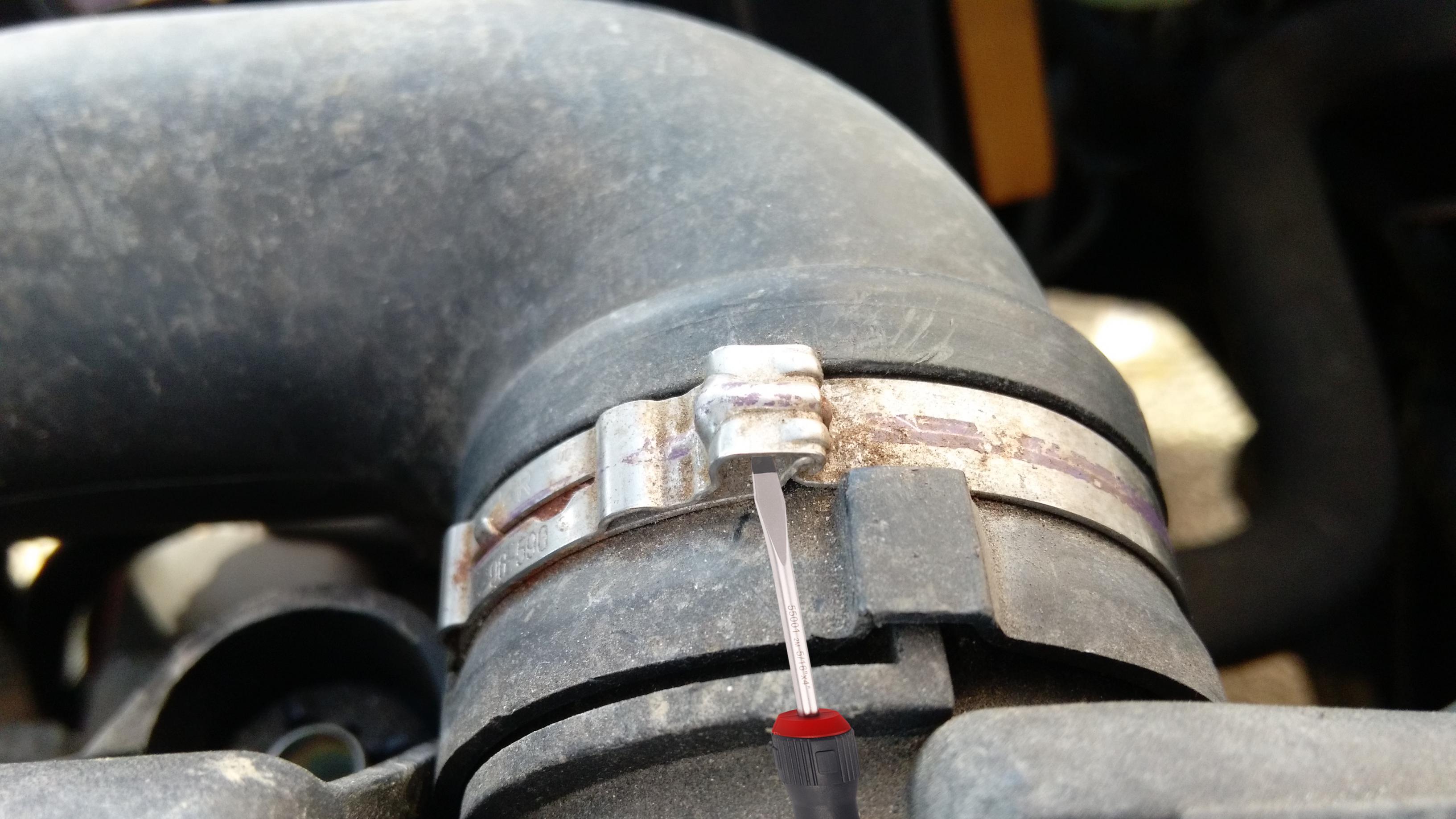

Was having a go at trying to change the Spark Plugs today but can't for the life of me figure out how to undo the clip that attaches the airbox to the hose - looks like you need some kind of special tool to get it on and off.
http://imgur.com/a/w2Mck
flat screw driver in and pry it apart
you need new clip afterwards

Cheers, that worked perfectly
Although was still a struggle to get the box off, but got there eventually.
