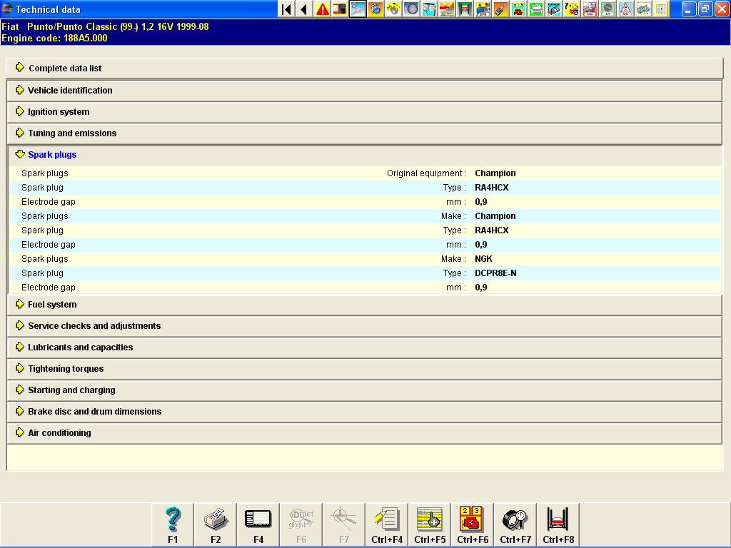

Thread, length, diameter, gaping, etc all identical only - only difference is how quickly hot / cold the plug is.
