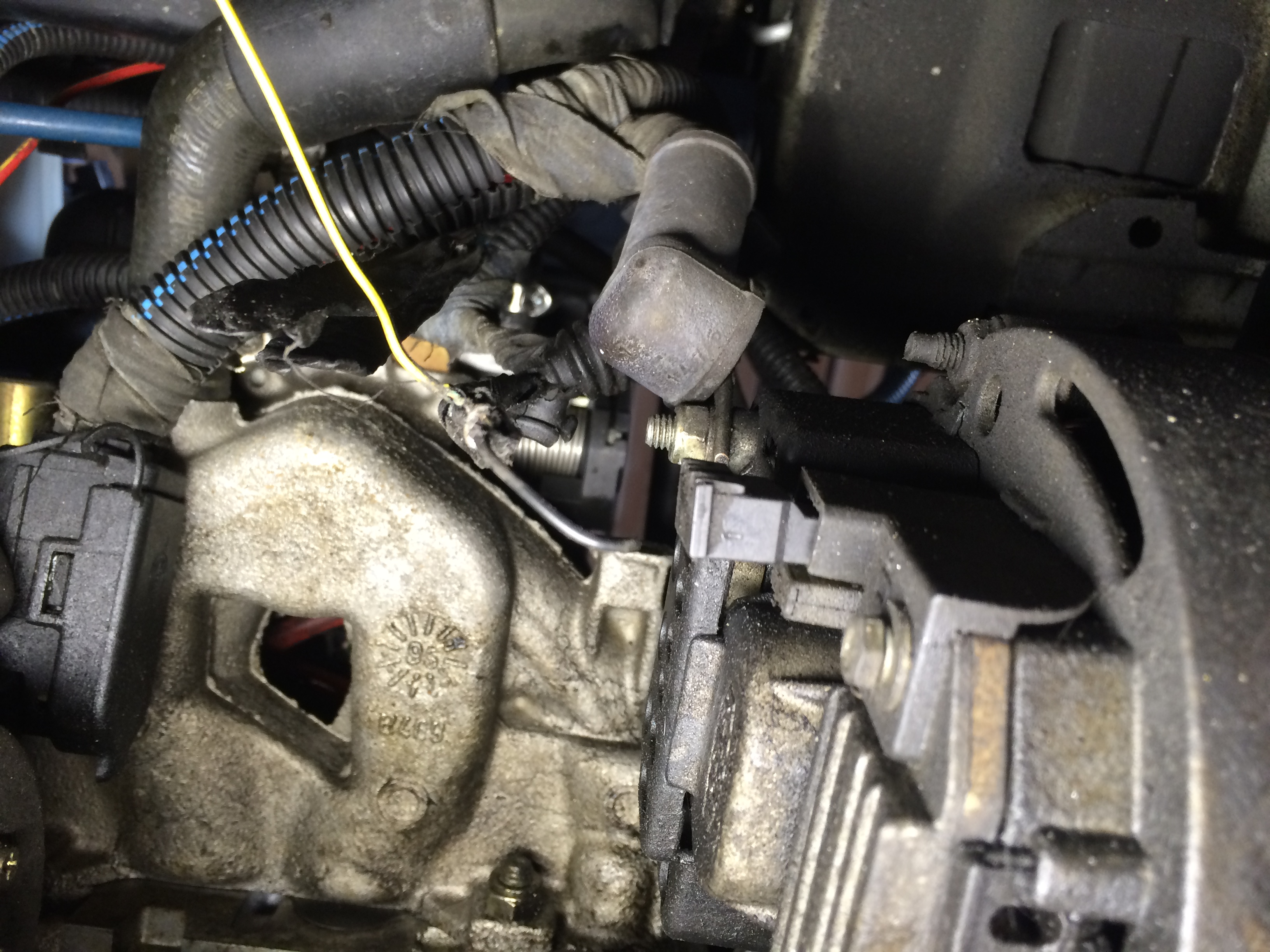

I suppose the wire that's come loose from its connector is what's called "sense"?
Old alternator (generator?) is out, new connector fitted to the wire. Trying to get warm before finishing the job.
Bloody top bolt length! :mad: lol
