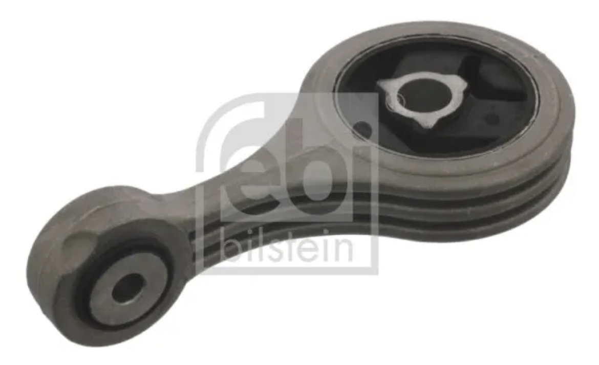

You are meaning this part as the dogbone yeah?
The mount between engine and subframe??
When I had the car on the ramp yesterday, I made sure the bolts were nice and tight. I can’t lie, the bush does look abit worn but I’ve never had any problem with other noises coming from this before. Would a noise this bad really develop that quickly and for nothing cause since doing the wishbones I haven’t touched that part at all. Last time that part would’ve got fiddled with would be when the subframe was replaced and like I said before everything was fine after having frame replaced. The noise only came along after I replaced the wishbone so I’m in a bit of a predicament 🤣🤣
Well I know the bolts are nice and tight (done up with dewalt impact 😂) I’ll get it up on the Jack later an give it a good wiggle an see if theres any noises coming from there.
