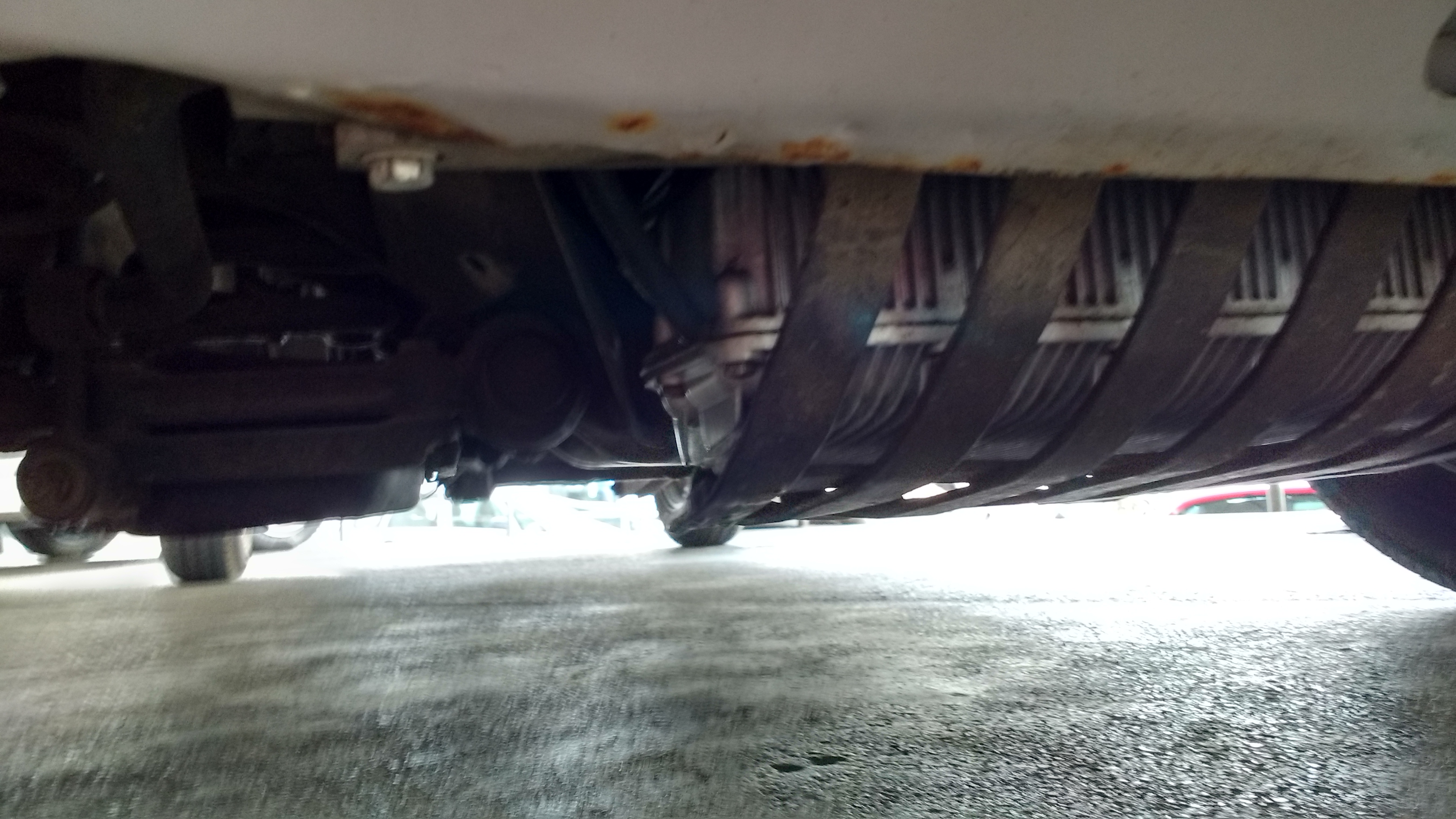

In anticipation of next weekend's fun, I refabricated the sumpguard to fit around the Bravo downpipe.
My question is what are the pro's and con's to adding a sheet of aluminium over the whole frame - acts as a sledge, gets full of mud, raises engine temp a bit. Versus - more complete protection?
What's your opinion, good idea or not?
I've been asked twice this week - 'Why's your car covered in mud?' and been able to reply - 'That's not mud, it's smelly stuff out of cows.'
But back to sump guard designs.. no sign of scratches anywhere after last weekend (just loads of gearbox oil as usual) so I think I'll leave it as it is until we get an idea of where to put more bars.

I'm definitely going to be looking at some sort of prop shaft protection method. :eek: Removing the centre support bearings is a pain, definitely want to avoid that as much as possible in the future!

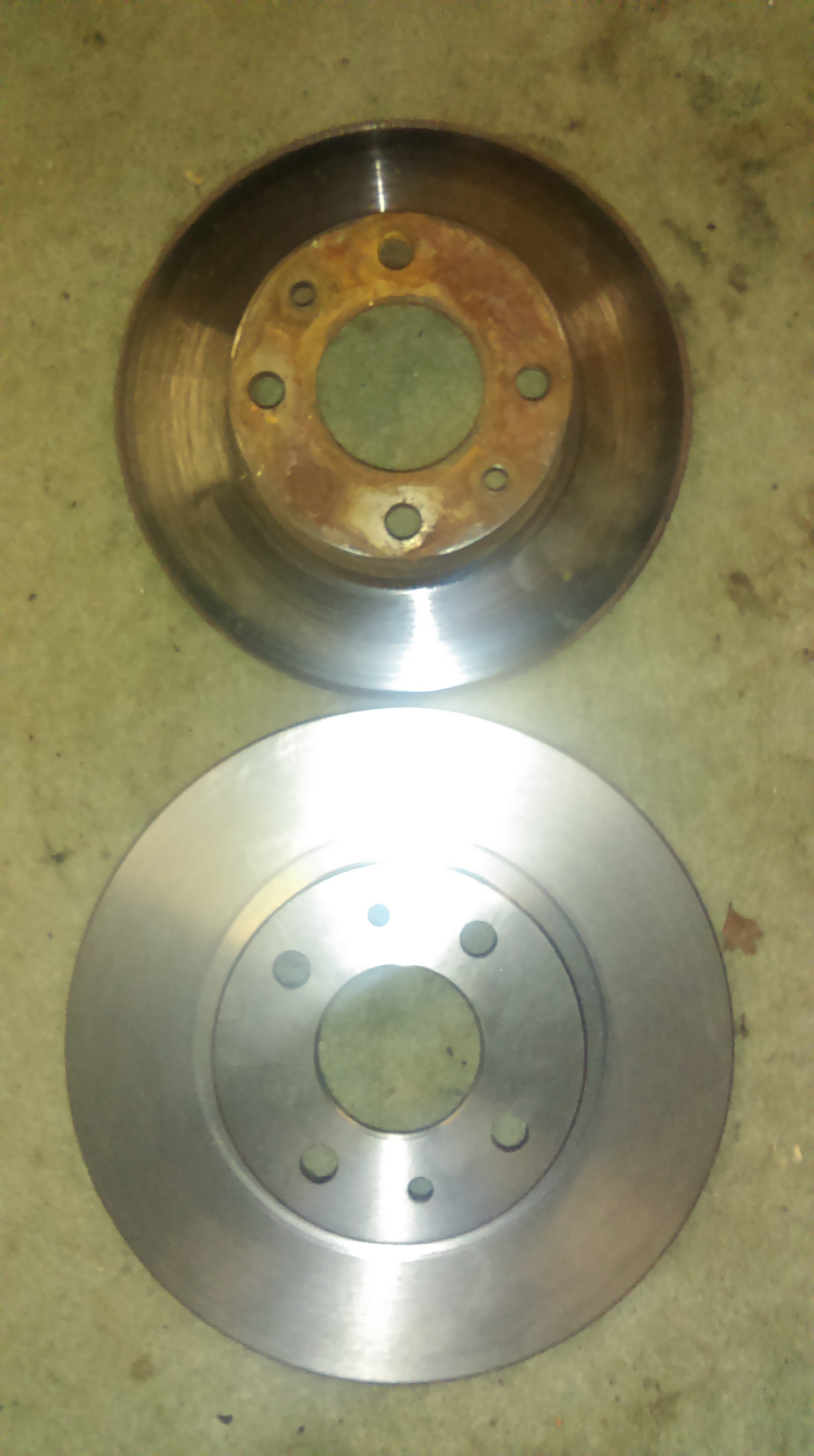

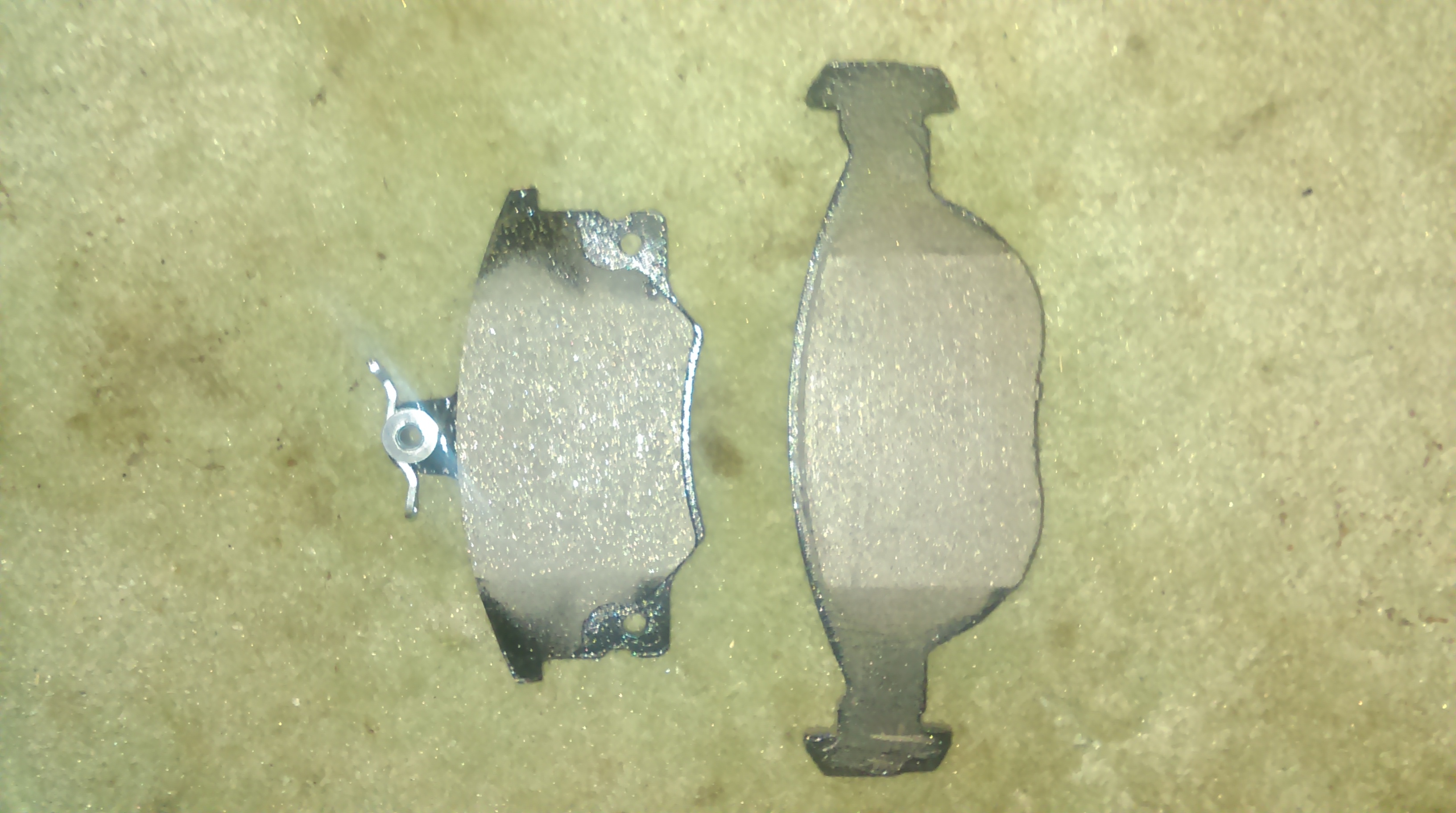

Finally got my stuff together to attempt this brake swap:-
Disc diameter differences 227mm V 257mm
Pads similarly extended
The mounting plates have been redrilled to match the Punto caliper and those silver spacers made, to get the caliper to line up with the disc. - I hope..
More tomorrow once I've had a go at throwing it all together.
