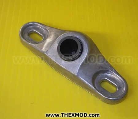

On the older big vans there were two large spring loaded plastic cups which engaged with metal trumpets/pyramids at the final engagement of door in frame if correctly aligned.Something like this photo, if door correctly aligned these help pull the door in correctly.
Yours being newer may have some other method.

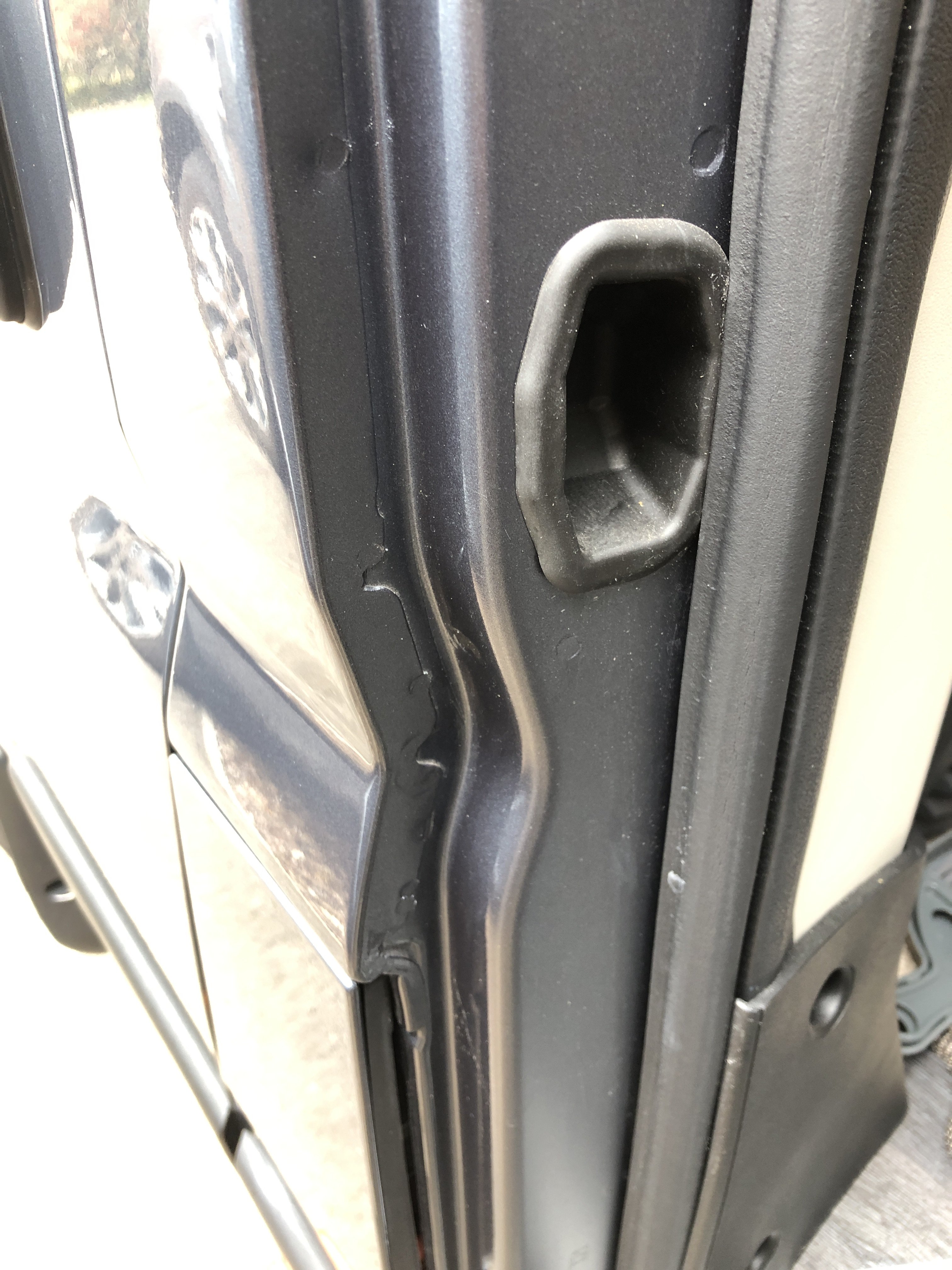

This is what the sliding door frame front edge looks like. I’ve tried removing the rubber insert but it’s either very tight or glued in. The door has a corresponding profile rubber grommet. The rubber insert appears to line a possibly metal profile in the vehicle body shell. It’s solid and doesn’t deform if pushed so there must be a metal pocket behind it…?
Is it possible the part it engages with has some adjustment.
Are there any signs of misalignment/wear in one area? The door catch may need adjustment also. I assume nothing inside like trim or carpet is holding it out of line?

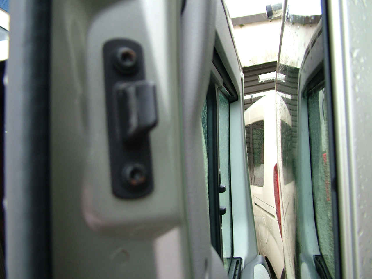

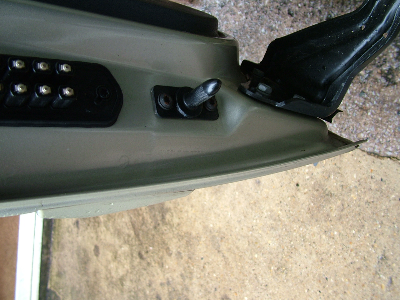

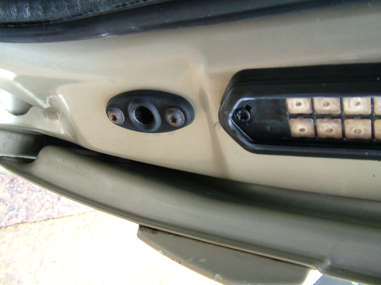

On my 2010 LWB Scudo the top and bottom sets are different but they do seem adjustable.:)
