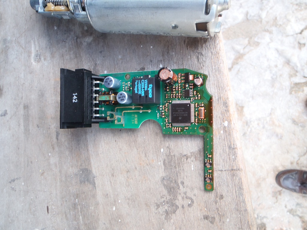

This is what the circuits look like before the cleaning. What do you think about it?

I believe that it hasn't got oil in it.
If you look closely, you can see that the board it self gained a different color in the places that were in contact with oil (right side of the board)
My biggest preoccupation is the "stain" on the right side of the board (front image). Looks like the oil has gone inside the board, "merging" some of the connectors :(
I don't think that would cause any damage to the PCB.
Clean the PCB with electrical contact cleaner, then plug just the PCB (not the motor) into the wiring. Check if you can hear the relay clicking when you operate the blind switch.
Also check that the motor (without the PCB) works with an external power supply from the car battery. Reverse the polarity to check it works in both directions. Be careful that the white plastic gear wheel does not come out while checking the motor.
Tried it but unfortunatlly the relay haven't done any sound (n)
Looks like the PCB is dead...

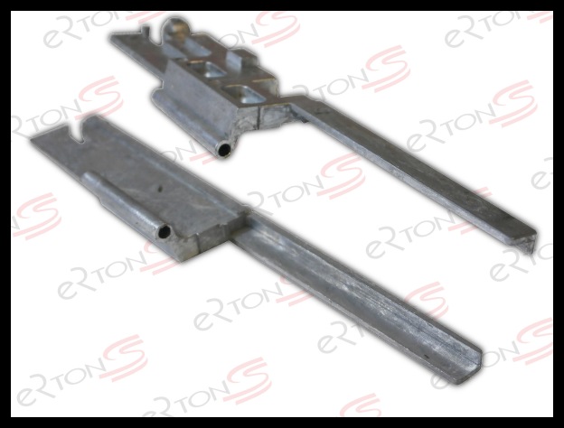

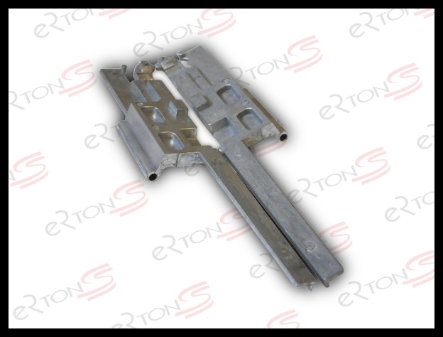

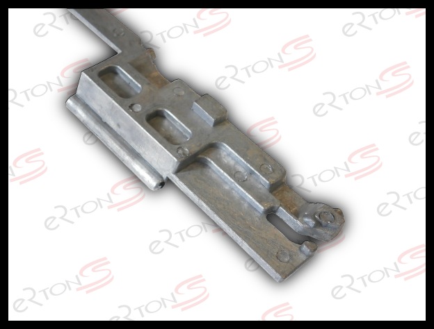

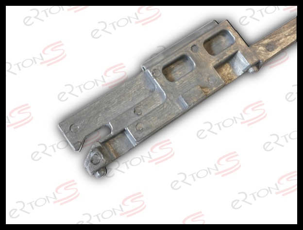

Any idea what these are for?
And what problem would they solve?
Found them for sale on eBay as a Stilo sunroof repair kit.
They are supplied as a pair (1 left & 1 right) for £12.50 plus postage from Poland.

Hi, not sure without going out to look at my spare roof. Perhaps part of the mechanism, but nothing that I think would be susceptible to breaking.
The cable, glass breaking and motors are the parts that go on these from what I've seen.

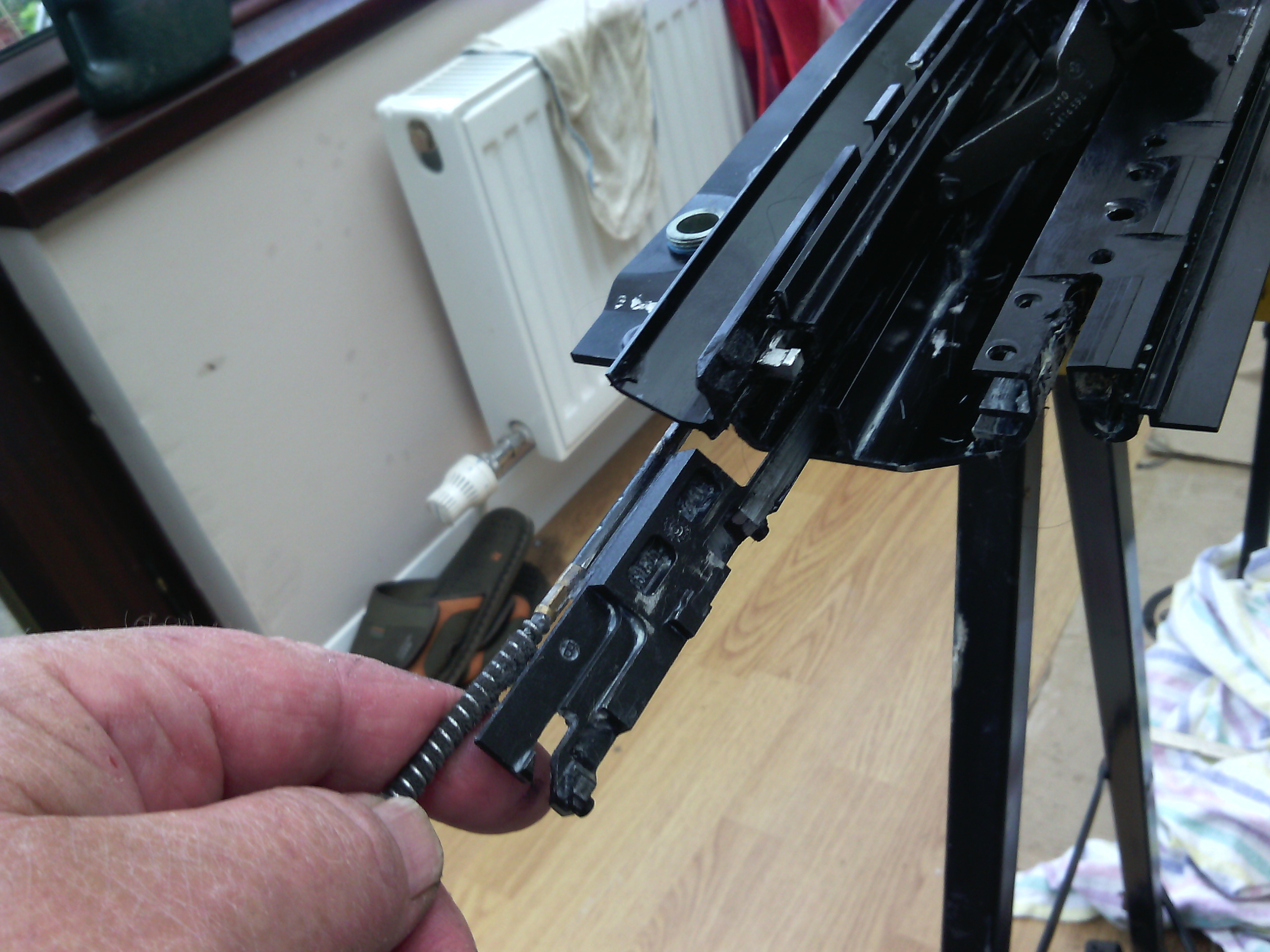

They are the front sliders I have all my sunroof in a heap in my conservatory waiting of two coming from poland. Mine are not broken but there looks to be a lot of wear they slop about and keep sticking and are covered in grease. Where they are its not very easy to get in with even aerosol grease. I have attached a couple of photos one showing where that part goes thats the front of the roof showing.I have taken loads of photos but I dont know when I will ever get to sort them out into some sort of order.
