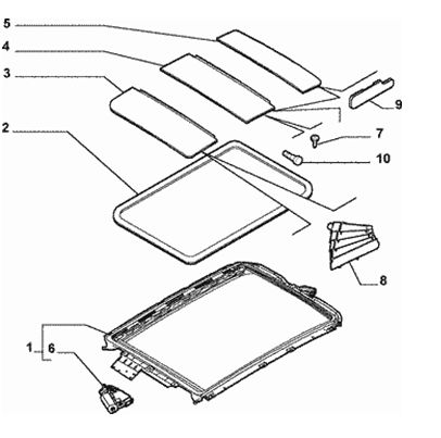

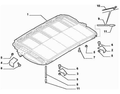

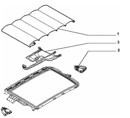

ePER is the Fiat electronic parts catalogue, the diagrams are very vague and only intended for locating part numbers. Here's the diagrams anyway. Only the numbered items are available seperately. Most of the parts are obvious what they are except item 3 on the last page which is the electrical wiring loom for the roof.
Dave.

Thanks that really great! Can you get descriptions and part numbers for that? Also how would i access that should anything else go wrong?
I THINK... i need number 10 on the first page, that seems to be the cable that operates the glass panels. It could be 9, 10 or 11 that i need on the first page, maybe all. I'll have to phone back Fiat again tomorrow since they weren't at all helpful the first time, but this should help!! :)

Items 8 & 9 on the first diagram are drain tubes to drain water from the roof channel.
Items 11 are one way valves for the drain tubes where it exits under the car.
Item 10 is just a cable tie to hold the drain tube in place.
As I said in post #7, the operating cables are not available seperately.
Dave.
