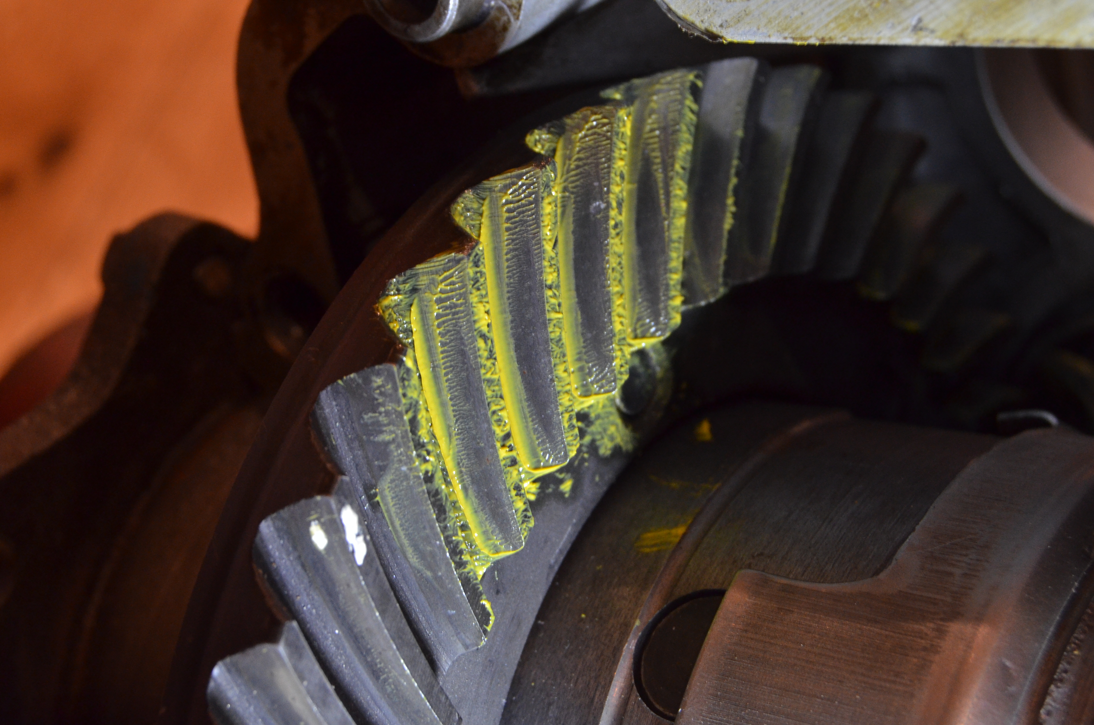

I've taken on some experienced advice from Bleeding Knuckles and Toshi 975, combined it with the information readily available via YouTube etc. and made a start.
I haven't yet got a stand and extension tubes for my dial-gauge so all I've done so far is to assess if the pinion depth into the crown-wheel is about right. I'm told that it should be, if assembled properly before I dismantled it, as the new gearbox bearings probably don't change the settings. It wasn't right at first so I took out a shim, played with the backlash, checking it by feel and adjusting with my homemade tool. Eventually, as seen in the last image, I think I got there with a contact pattern as shown in one of my manuals. There are conflicting images of the ideal contact pattern in some websites but I'm happy with this for now.
So next thing I need to properly re-assemble the differential and bell-housing and then to check the backlash using a gauge, set the bearing preload on my home-made support frame and the final crown-wheel contact pattern, which I hope I can see through the input shaft hole.

Now that's a pretty colour !!! Well done Peter, looks like you have good full width contact and good depth too. (y)(y)(y)

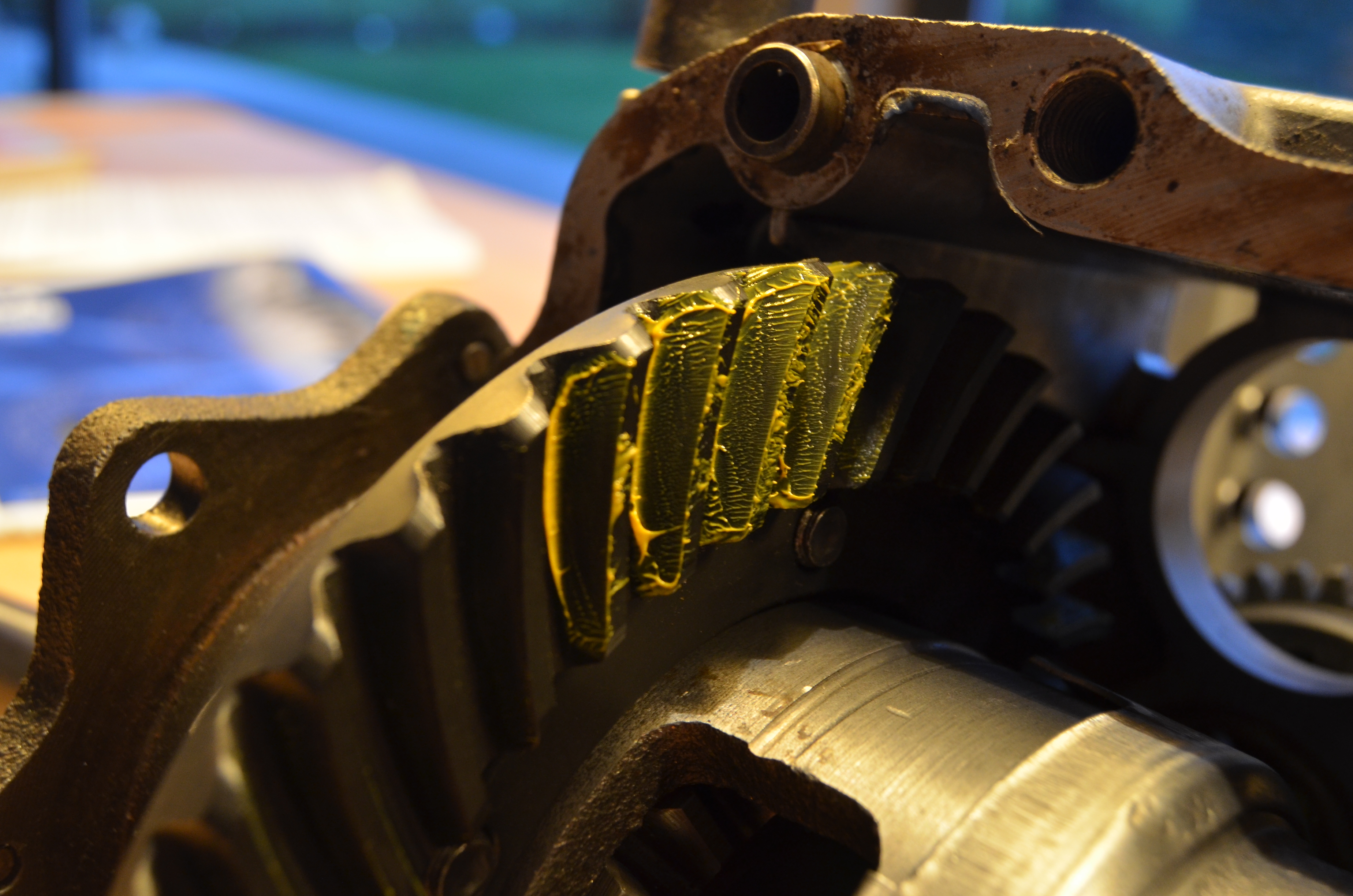

I'm a bit mixed up about what the gear-pattern should look like. Intuitively I think mine looks good and agrees with my "Motorbooks" Fiat 500 manual. But there is conflicting information on the Internet and on various bits of literature I have amassed.:bang:
Hello Peter, When I did my box I always remembered something I heard in school MANY years ago in the engineering class " with gears, no matter what type, if you can achieve a full width - full depth pattern without the gears bottoming out you are about there"!!!! That's old school teaching !!! If I may say it looks like you have good contact all round (y)(y)(y)

Thanks again for the reassurance Ian. Apparently most cars now use hypoid diffs which means the pinion engages below or above the centerline of the crownwheel. So I'm assuming that the simpler and less stressed geometry of the 500/126 setup allows a more uniform contact pattern. I've got my sealant so it goes today.

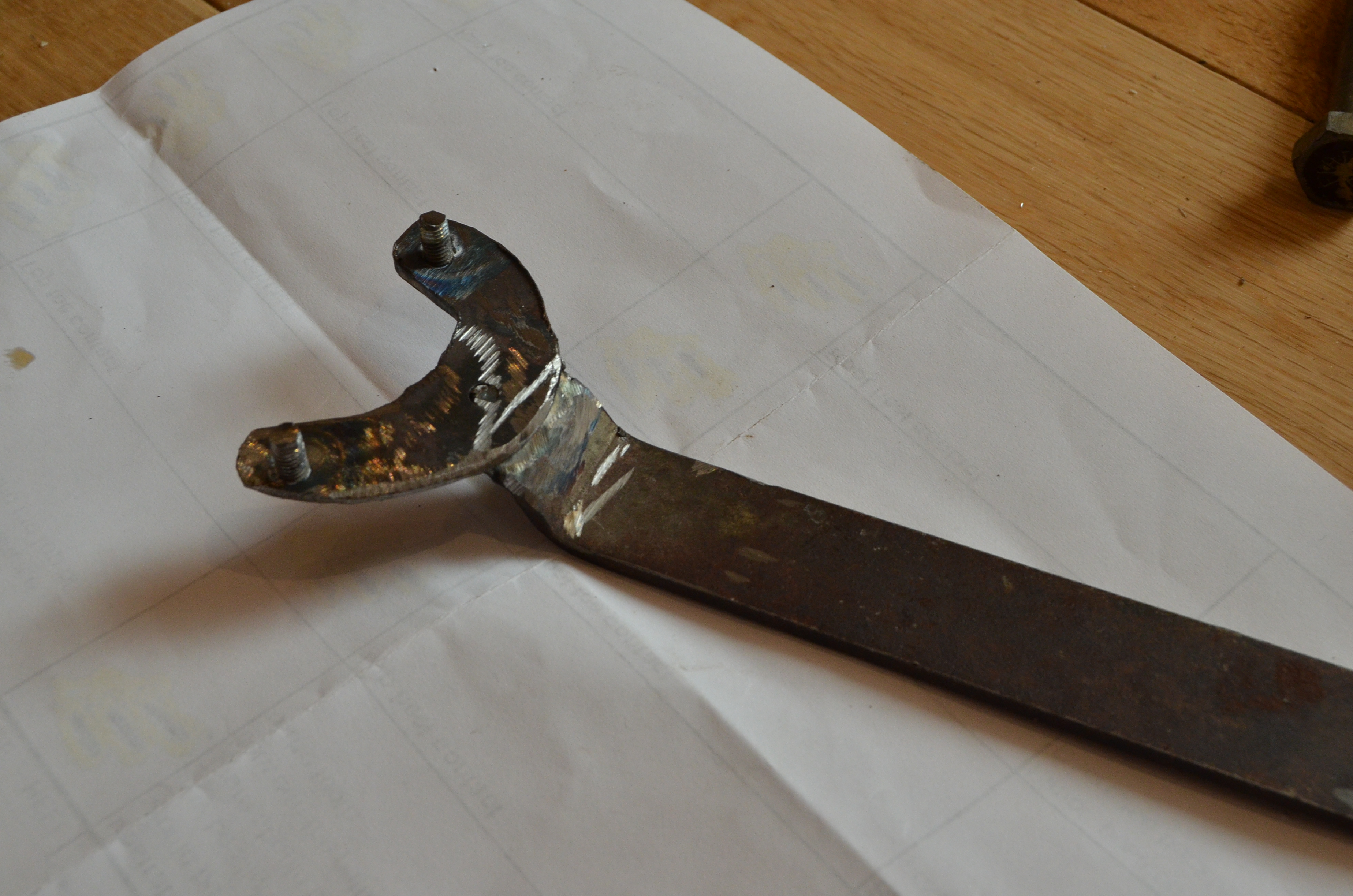

I'm now on the Mk.III version of my bearing adjuster tool. As you tighten the serrated rings to put on the pre-load it takes a great amount of force to turn them the fractional amount which applies the pressure which creates the rotational torque. Consequently I bent the handle and had to weld on a stronger one.
You do really need the level of control that a proper tool gives because as you approach the correct backlash setting and then the torque setting, very minor over adjustments can easily upset things. You really have to follow the Haynes advice which suggests rotating the bearings after each adjustment to allow the bearings to centralise and give a true reading. So I've been messing about for ages to get this right, which involves constantly removing and replacing the dial gauge, clamping and un-clamping one of the driveshafts or the end of the pinion shaft depending on what I am adjusting. But finally I think I have it about right.
