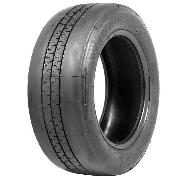

Hi I recently bought a 97' Cinquecento Sporting, and I wanted to do some upgrades to the car. The first things that i want to upgrade in my car are the suspensions and brakes. And I was thinking if I can fit a semi-slick tyre on the standard 13" rims of the cinque.

If you are feeling generous, there is the Classic Michelin TB5F in 185/55R13, but they are £290 each...
