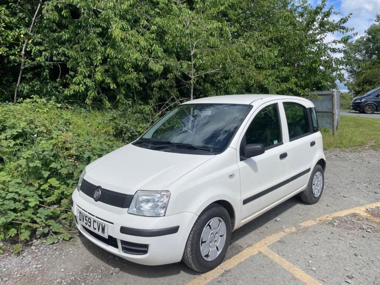

2009 Dynamic Eco just failed the MOT. Do you think anyone would give me over £200 for it or should I just send it to the breaker? Shame really, as the mechanic said it's a tidy car apart from the fails, the welding underneath is apparently fairly minor.

Knackered suspension, over heating engine, body rust and a host of other issues, it’s probably only fit for scrap. You could always try and sell it on Facebook or eBay as an MOT fail, someone might want bits off it, or you could break it yourself, but honestly £200 is probably pushing it.
^^^Yeah, I thought as much. Breaker should hopefully offer in the region of £170, that's about what I got for 2 similar cars last year, and I won't have the faff of advertising and whatnot.
Although according to the mechanic it's not as bad as it sounds, suspension is just the bracket holding the spring up, minor welding, minor brake fix (had same last year), fan doesn't work properly, common problem according to this forum. Does seem a shame but the sums just don't add up. I'll contact the breaker next week if I can remember their name. 😵‍💫

The usual thing with rust like this, is once something has rusted and needs welding, you'll spend the rest of your life chasing the rust from one bit to the next.
Also these rear beams on the Panda can get really bad and the repair is only as good as the metal you are welding it to. You could weld it up and the next bit of metal along gives way.
With over heating, its fine and easily explainable that the fan isn't working so it over heats but these little engines don't like over heating and what was caused by a faulty fan can quickly turn to a blown head gasket and warped cylinder head. So again fixable but who know what other damage has been done. Might be none, might be terminal.

Once the rear beam has corroded to the point of being a dangerous MOT defect, it can't be repaired by welding. Complete replacement beams can be had for reasonable cost, but unless you can do the work yourself, the labour element would likely put fixing just this one thing alone beyond the value of the car. Throw in all the other failure items, and letting this one go becomes a total no-brainer.
