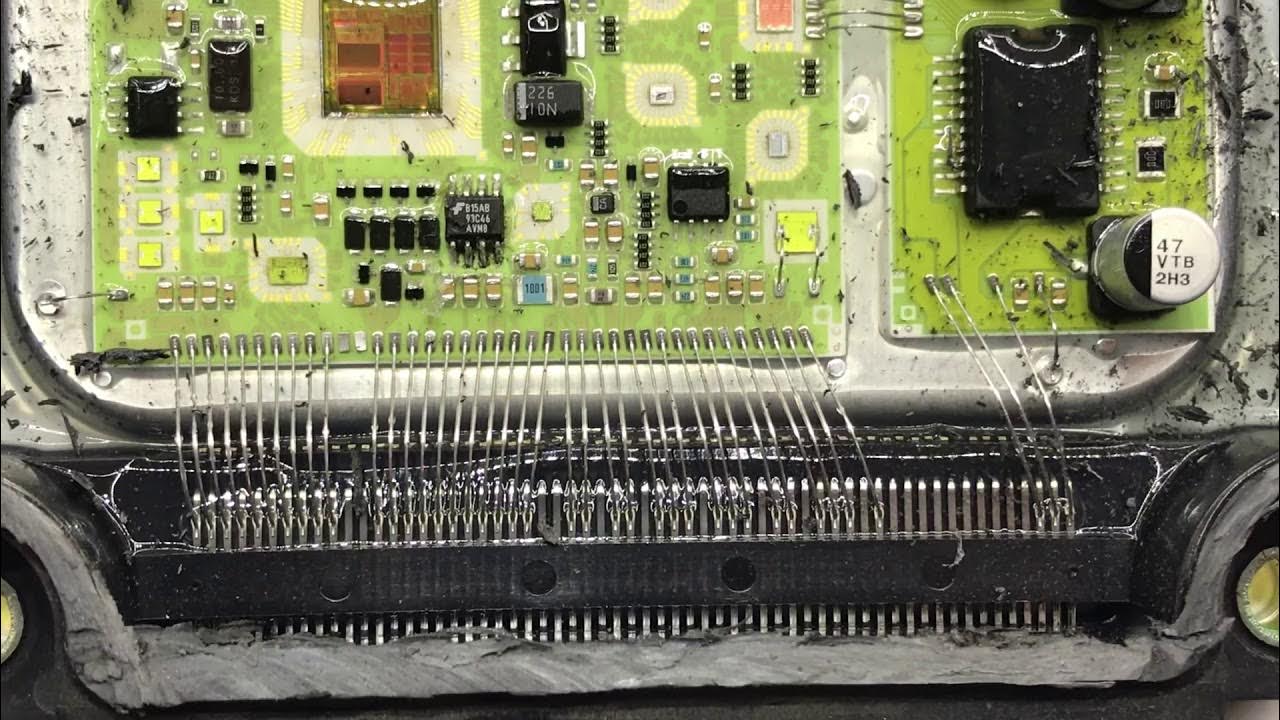

having taken these ecus to bits im of the persuasion seeing as the wires are thinner than a human hair that for long term longevity they are NOT repairable

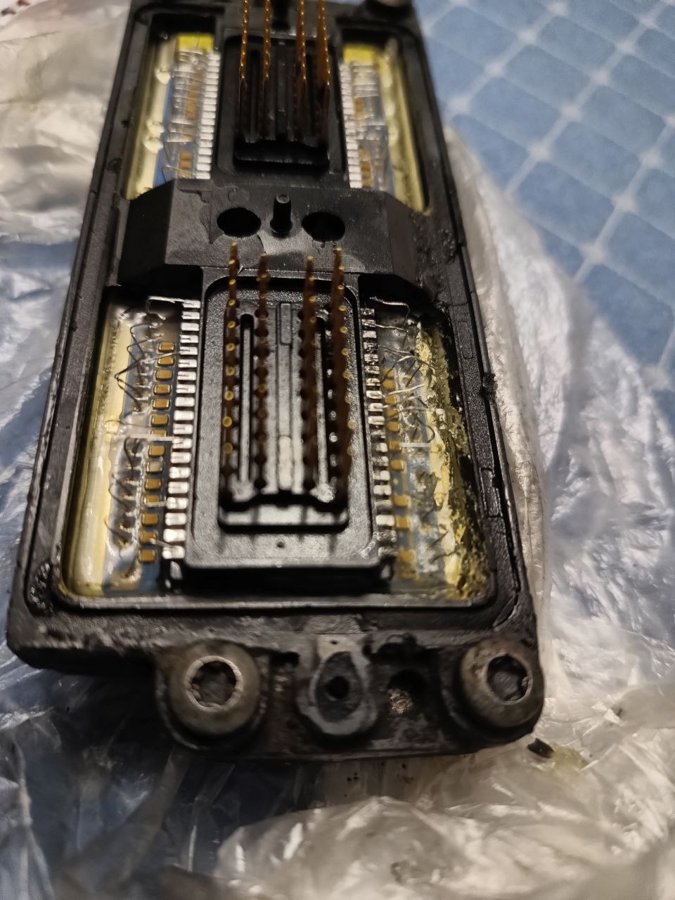

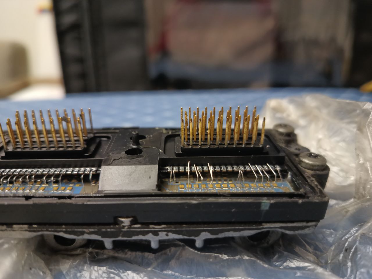

I am having a huge issue with mine at the moment.... I am stupid, and opened mine because curiosity gets the best out of me, and snapped most of those pesky wires... I can't seem to be able to solder them back for some reason, it's as if they were on aluminum or something alike. With your experience, have you ever been able to solder/desolder anything inside? If so, have you removed the sticky gel inside? With what?
Am I royally screwed?
Some wiring can be impossible to solder (classic way, tin-lead). It was probably resistance welded (or soldered with "hard solder" or so).

Here... This is a cautionary tale kids, of why it's important to research first before doing something you have never done before... It hurts in the eyes, but well, at least I learned that it's easier to buy a different one.
So, it seems that I will be buying one of these self coding ones.... any idea how I should search for them? Mine are the following, and I found one on Ebay for the exact same code IAW59F.M3, but I am not sure if the same HW### matters.... can I get a .M5 instead? Can it be .VG or something different than M3 or M#? Does the model matter at all or is the form factor the most important part?
You need same code but hw303 is a better replacement.
