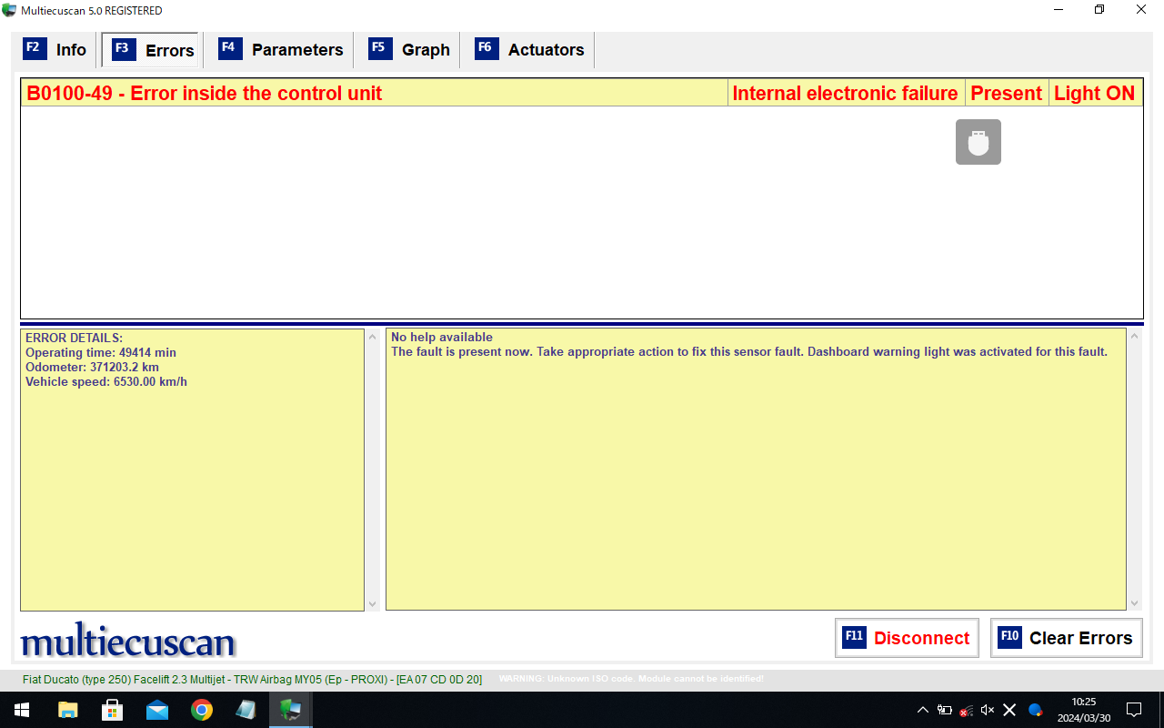

When I started the engine in morning, an AirBag error occurred.
Code was B0100-49 and it's meaning inside the control unit error.
In generally ,this error seems to be caused to battery voltage value, but I do not think.
Battery voltage was around 12.5V.
It was the weather such as the winter storm the day before.
At the morning, it was low temperature and high humidity.
I confirmed that included dew condensation inside of the front window.
Therefore, I think that dew condensation caused a trouble.
In Japan there is almost none of the ECU repair shop, especially Fiat cars.
So I purchased new one.
The DWG number are different, Old one is1393755080 and new one is 046858203.
These seems to be compatible.
