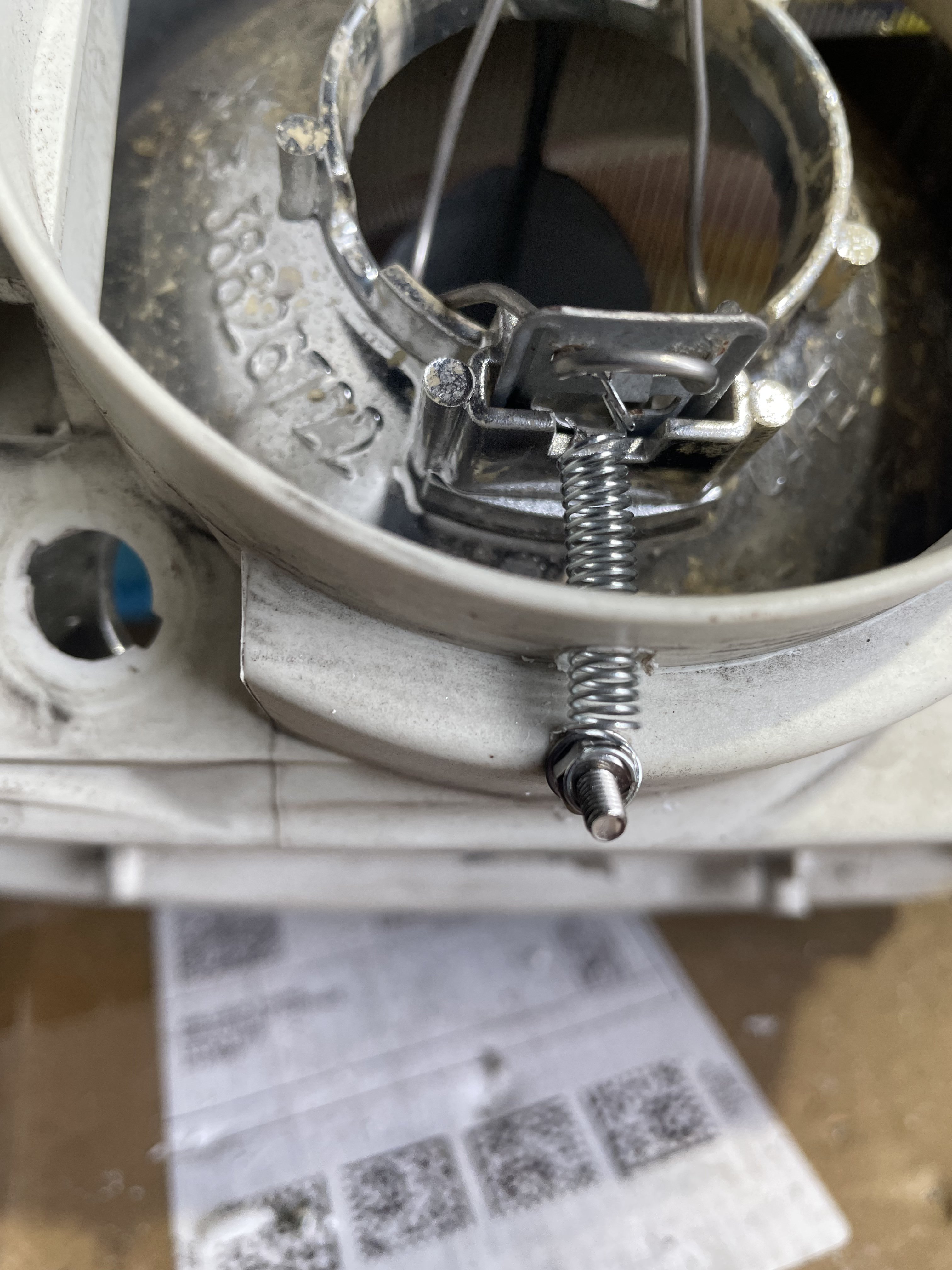

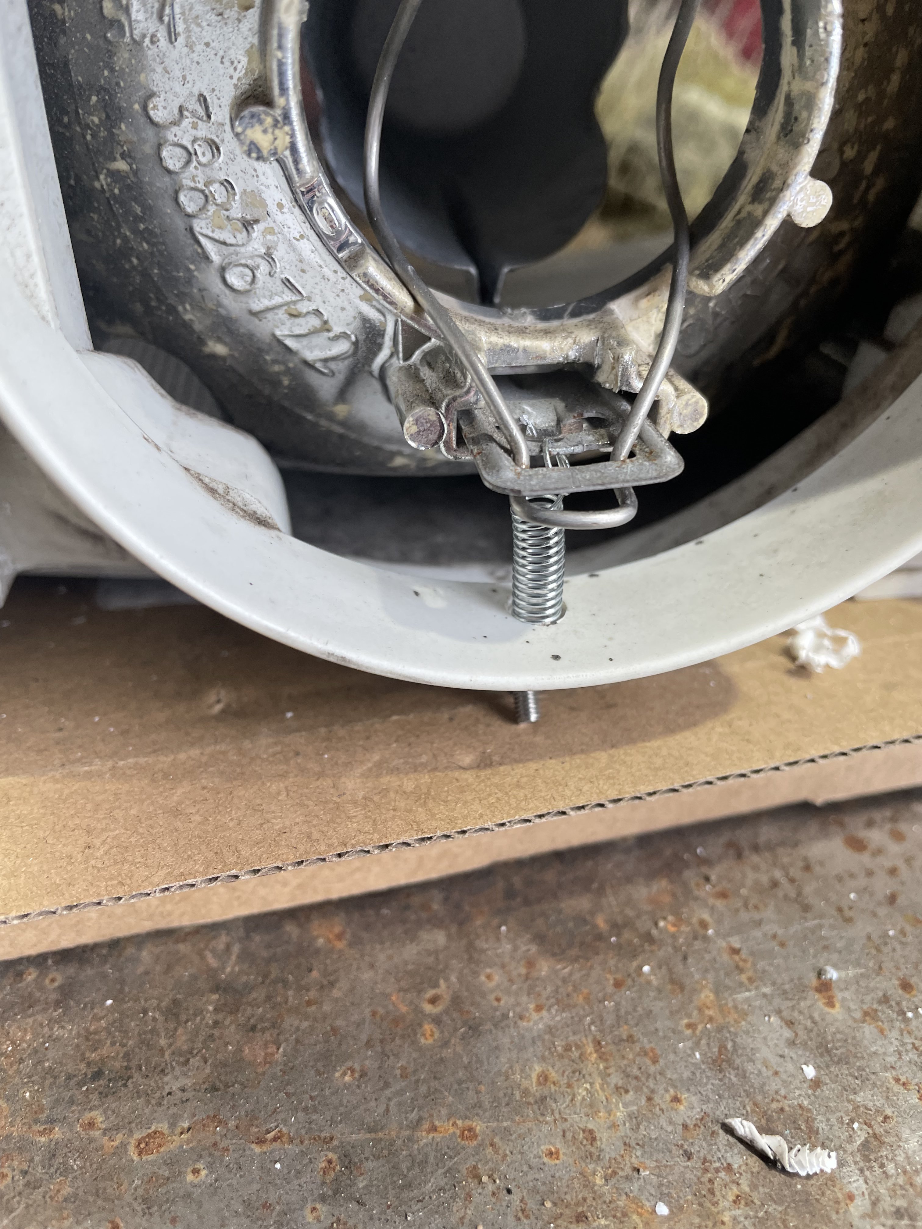

Hello Folks
As mentioned above I had the same issue as most Seicento owners have regards the adjusters on their headlamps(the cups that that the motor ‘ball’ fits into to push the lens up and down). After reading the ‘attach spring’ method I have done my interpretation of that ‘fix’ and having shone the lights on my garage door and 2 feet distance I’m pleased to say that both headlamps now adjust at the same rate. Hoping the fix is good enough? I attach a couple of photos of my ‘spring fix’. Not sure the longevity of the springs but can upgrade/replace again if needed.
Best
Malcolm

Looks like a nice fix and I hope it works for you. I think the Seicento headlights are harder to fix compared to the Cinq units.
I found that mot testers always create hassle and damage the headlights so I replaced with new LHD lights as RHD are not available. Last couple of years they were very reasonabe, priced at about £50 but now £83 including bulbs. You have to swap the glass lenses over from the RHD lights so they pass UK MOT. Every MOT they were causing unnecessary agro...
Thanks for the advice. Yes was looking at the L/H drive units like you say have gone up in price. Might go down that route in these things don’t last. Got plenty of spare springs(eBay) so might get away with it for a while. I agree that MOT testers are getting more ‘anal’ despite them having less opportunity to ‘test’ things like in the ‘olden days’. ‘Advisory’s’ etc are more ‘opinion’ these days ..
