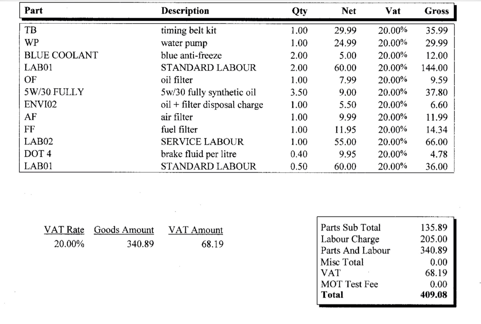

Been in for service & MOT today. Got the parts from Shop4Parts using the FF Dizzy code. All good except they sent Paraflu UP Red instead of blue. Garage spotted this so used their own blue, thankfully.
Also got sent Selenia K/PE instead of 20k but I guess that's better being fully synthetic.
Aced the MOT. Car is mint underneath. At under 26k miles, I guess this is to be expected:)
Still, 15 years old tomorrow so doing well.
