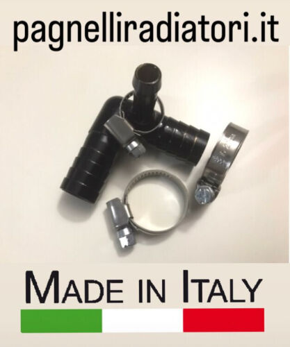

There is an italian selling brass repair piece (below) on ebay but they do not post to the UK and it costs £33 and the full replacement heater hose is approx £100 from Poland.
