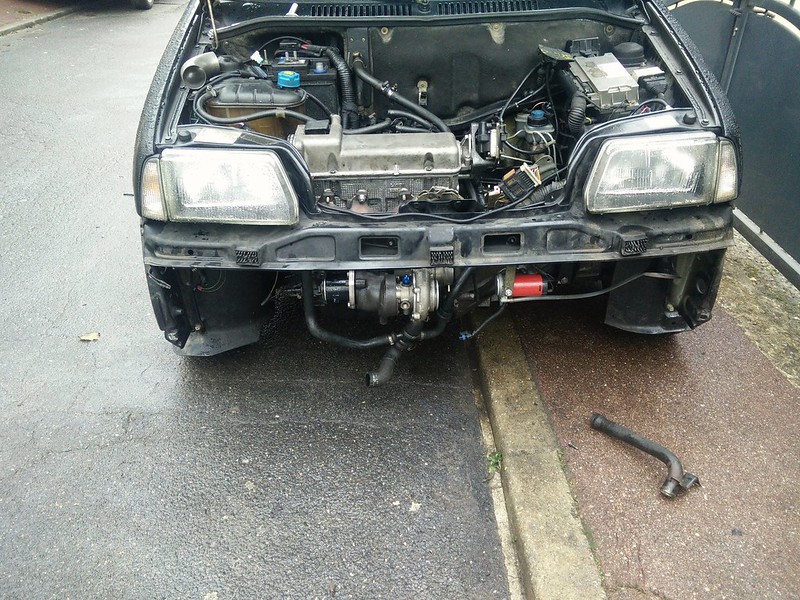

Cinq's exhaust, 54mm with Ducati's mufflers, Multipla's intercooler with oil cooler and Brazilian manifold for the T-jet.

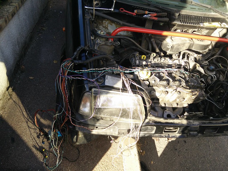

Installed T-jet, engine harness modification and Speeduino wiring with stock ecu plug.
