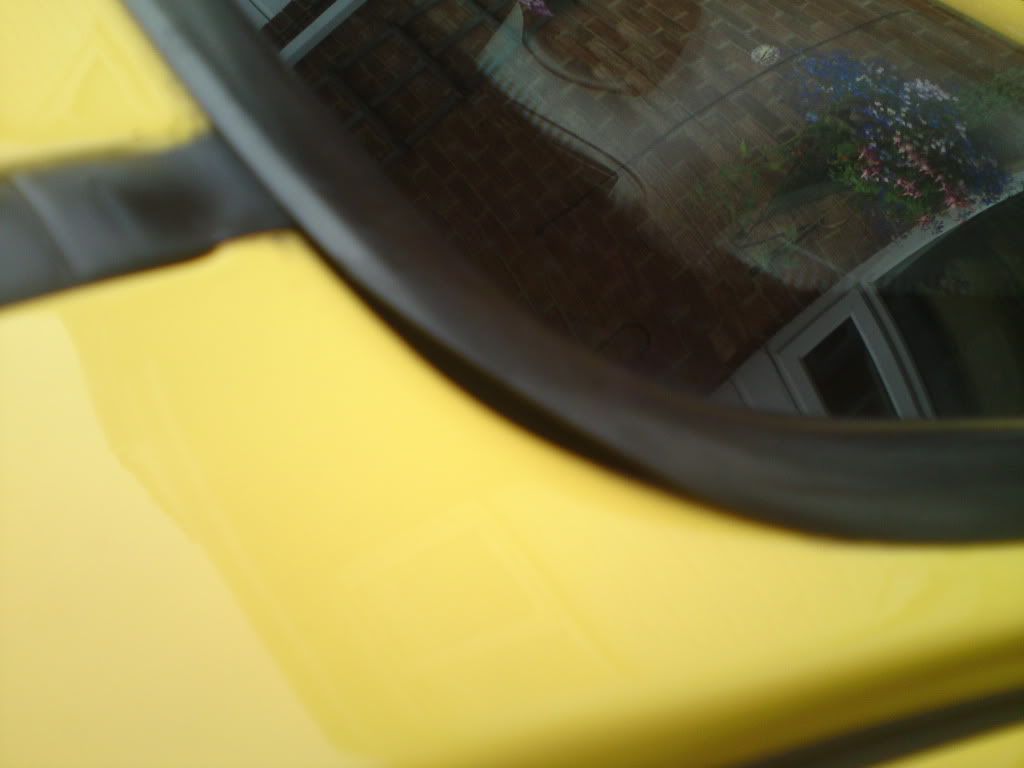

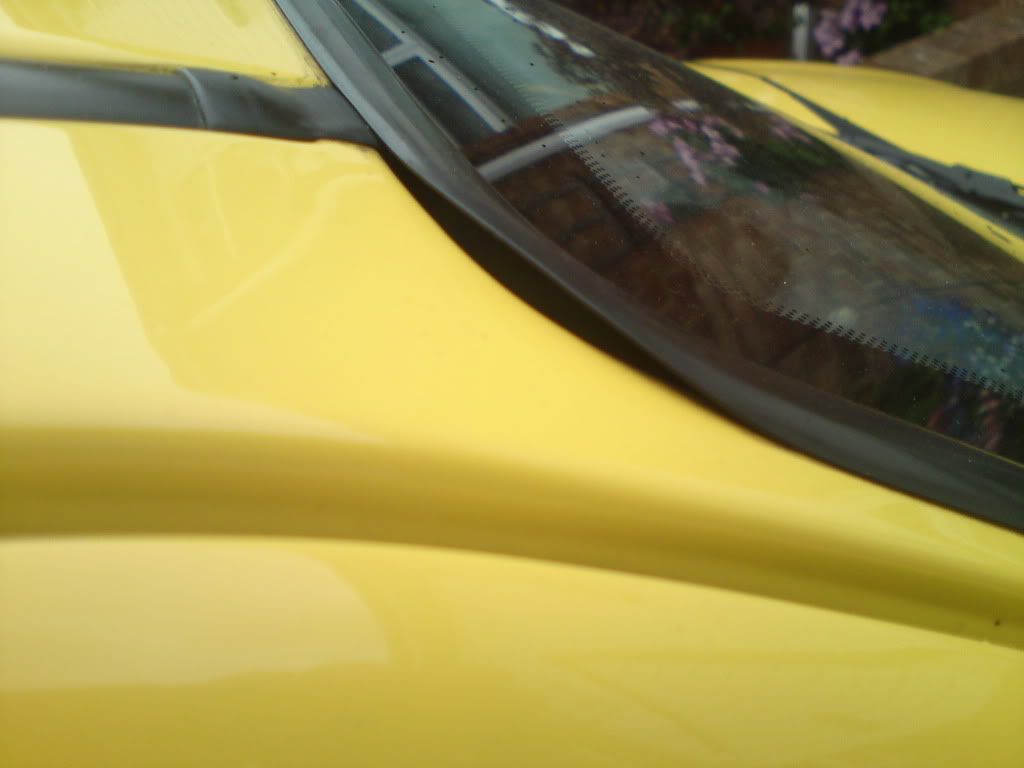

Have you got a picture of this bit of suspect windscreen...
Here is the pics blu, I did use my thumb to make the gap show more, its not normally as open as first pic.
the gap is top corner drivers side.
Not sure if this is causing leak, it all still seems pretty tight under lip.
