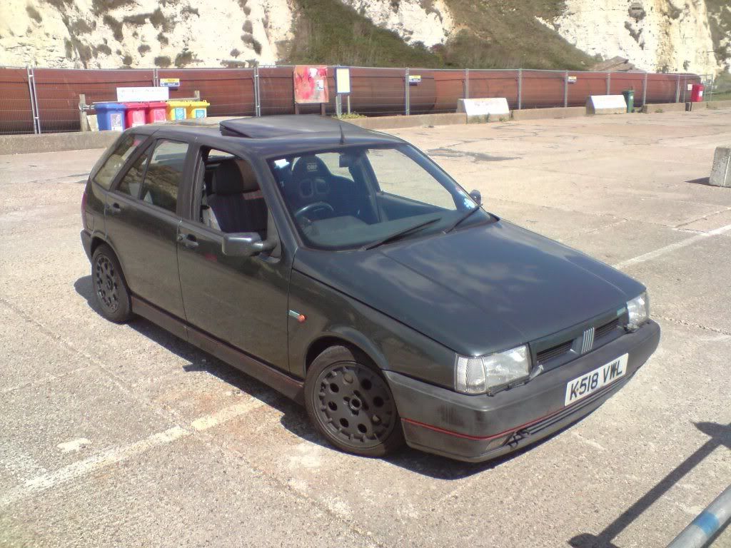

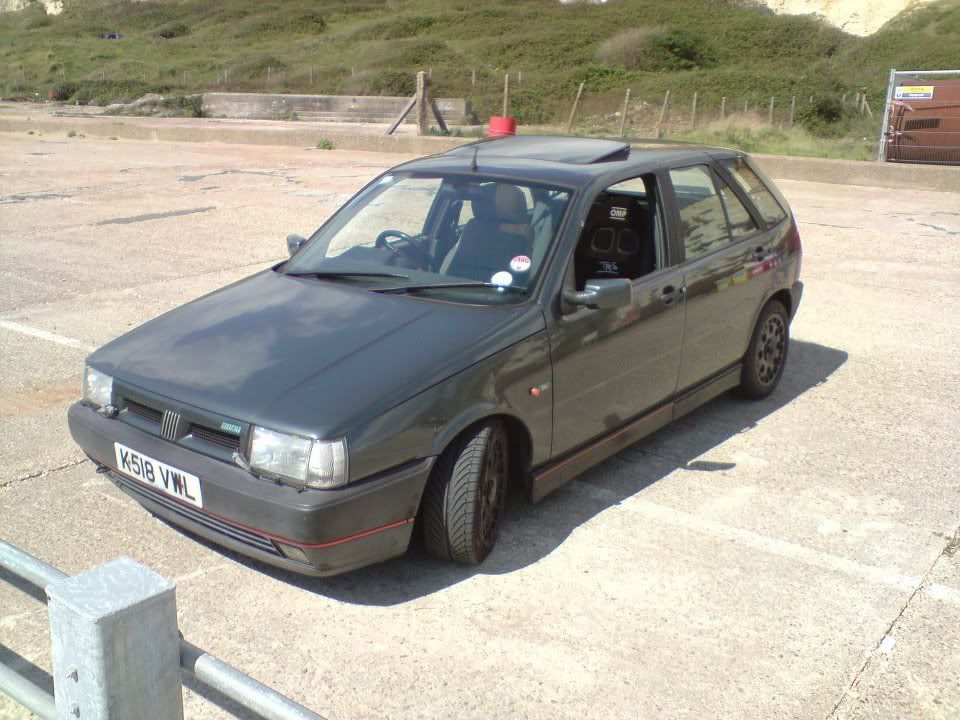

Here's a pic of the car, to add to your gallery
Thanks, Roger...............
Lowered 30mm at the front, AVO Adjustables at the back with 200lbs springs. 16v Integrale 7x15 wheels with 195/45/15's on the front and 195/50/15's at the back. OMP pads on the front. It has got OMP bucket seats and Willans 6 point harness' but only the passenger side is fitted as we havent got around the making the other side yet. We tried all the omp mounting plates etc and none of it fitted so we decided to make our own. One the engines sorted (turbo maybe?) a set of AVO Coilovers are on the cards to get the front sorted out
Hope you like it
