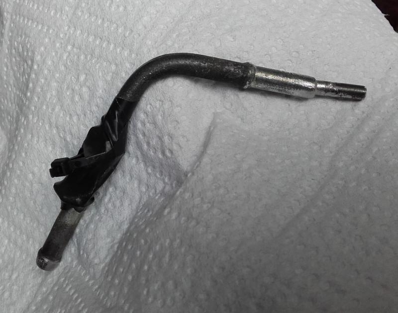

About three years after fixing the controller a new but related fault appeared. Every time the AirCon was on the engine lacked power and was very flat at pull away. There is a design fault that can cause one of the vacuum pipes to split.
I don't know how many of these vehicles had this problem. At some point, I think there was a bigger flexible tube running down to the actuator but the suppliers must have changed the spec. The joining block is a purposefully made item, so my thoughts are that they failed to update this bit when the tube spec changed.
At least, I would like to think that. I can't say that I have been over-whelmed by the build quality of these basically Hungarian built Suzuki's. They seem to be generally good value for the money and people tell me that lots of cars are built like it these days but that is another discussion ...
So, if you have have blowlamp and can solder, what you have to do is cut the flange end off of the offending item, to get a good capillary fit, and solder in reduction to OD 4.5 or 5mm.
I also had to cut the joining matrix into two, to get extra movement to compensate for the reduced available length.
