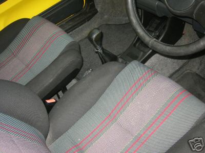

CInquecento Sporting seats fit straight in bolt for bolt, as do the seicento sporting (mk1 or mk2) front seats. To get the back seats in you need to get the little bits that let you out the seats down aswell (metal type brackets). Or you can fabricate some new ones quite easily.
Personally i'm a fan off the Seicento Sporting Abarth Mk2 Facelift seats (same as the standard seats, with Abarth logo's), i think they're very comfortable and look excellent.

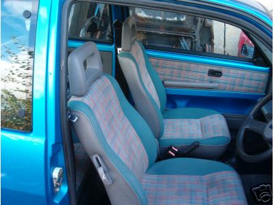

In the pics above, the seats don't look any different to Charlie's apart from
the colours are different. I'm still suffering from backache.

The Standard Sporting seats have much more side support than the S and SX seats do, they are definately more reassuring, the S\SX can get a little scary blasting around back roads cos I found I moved around quite a bit.
Ive never actually driven a Sporting with standard seats mind, but in my experience of driving the SX and being passengered in the Sporting, Id say do the Sporting seat swap :D Buckets really get very painful after an hour and a half or so of motorway driving, so thats a no go!!
well ive got a cinq sx which has the same seats as an s does so i swapped them for front and rear seats from and s reg seicento sporting not only do they look loads nicer, are more supportive when nailing it round corners but are more comfortable on long journeys.
