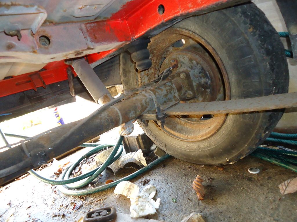

Got a chance to do a couple of odds and ends today. Removed the old exhaust (a nut and bolted rubber hanger on the tailpipe) a bit more brake plumbing.
I remembered to take my camera and although I forgot to take any pics of the servo mounts I took a couple of the underside.
You will notice that the axle is sitting on the rear spring. I will be mounting the 4x4 axle 'Under' the leaf spring (or hanging from it.)

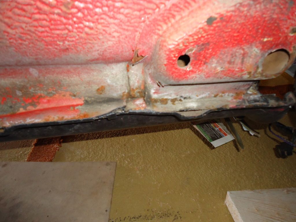

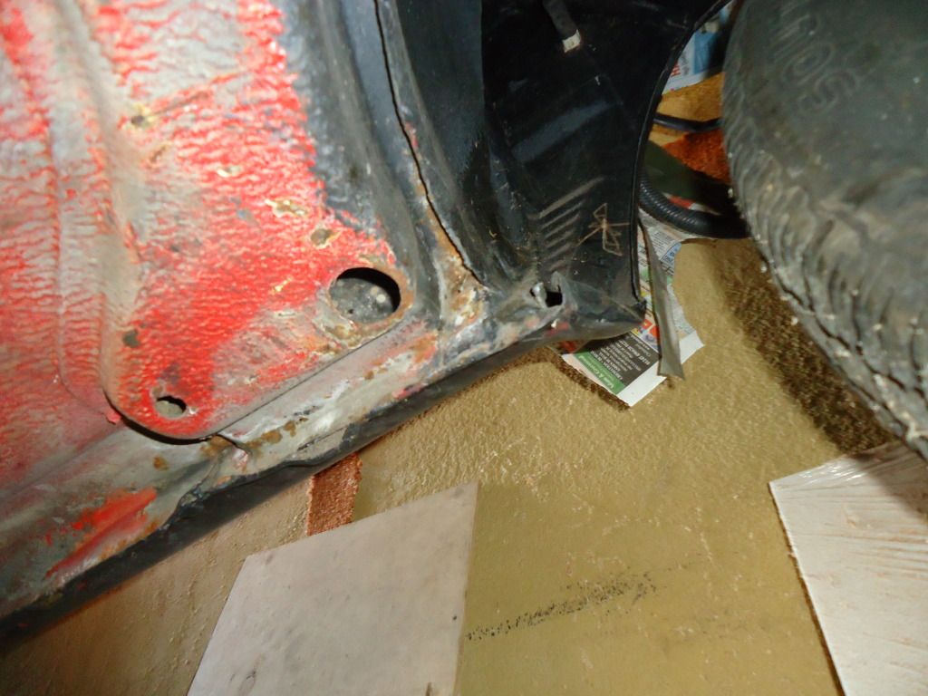

Here are a few random pics of the underside.
Not bad for a 1983 Fiat huh..?
Thanks for the pics. Are Mk1 Pandas axles mounted on top of the springs too?
Looks pretty sound underneath, but caught just in time to clean up and properly underseal.
